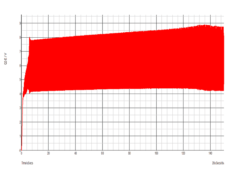

this is 150u
i don't understand, when i zoom is bad waveform, what to do next, what to do with lpf, you know, why i told about this simetrix, somebody told me is the best simulator, for that i said to you
michael1978 said:
this is 150uView attachment 228718
I don't understand also when i make 5u is good sinewave if it goes more is bad sinewave

Hey my dear i fix it, somebody told me, i just change The R4 to 360 and is working THANK YOU A LOTTTT;;;...… SO THAT I MAKE TIRED. THANKS

Sorry sir i wil like to ask the last one i think, everything was okej yesterday with sinewaveform, but today i connect the varicap and i start to get bad sinewave?
what do you think?
You must use the correct spice varicap model and parameters. I do not know which spice model varicap you are using.
You know the low and high frequency ends of the FM band. The Local Oscillator frequency range needed is offset by the IF frequency. You can calculate or simulate the capacitance needed to maintain oscillation at the ends of the band. Select from manufacturers data an available real varicap that provides the required variation in capacitance. Find or make a spice model of that varicap.
The BBY40 was originally used. I google 'BBY40 spice model' and find;

Each version of spice uses a different way to create and integrate new component models. You must become an expert in your selected version of spice. Take a look at an existing spice varicap model and work out what parameters must be changed to make your BBY40 model.
You may have to change other component values such as the LO tuning inductance and the surrounding capacitors. The original paper with the circuit includes a section on LO tuning and varicap selection, see page 5 and 6 of “Local Oscillator for FM Broadcast Band, 88-108 MHz”, from Lund University, 2012.

A varicap (or varactor) diode is swung by the RF voltage as well as the DC tuning voltage, so it creates distortion and harmonics. Varactor diodes were used as efficient harmonic generators at UHF before high power transistors became available. They were also used in parametric amplifiers, providing low noise microwave amplification.

Yes i see yesterday the same version like sir Balunce had, but maybe simulator is wrong like say Balunce

Thank you, i have the same model, but maybe simulator don't work, because eveything is fine without varicap, when i connect varicap everything changes the harmonics, whatever i have to do one other

Sir you kno what i make it, i remove the filteres and they work? WITHOUT FILTER

That is a very wise move.
I modeled the filters yesterday to find the low pass frequency and the design impedance of the interface. I found that they got something wrong in their design but I have not worked out what their mistake is yet. The more I look at that paper the more suspicious I am that it was a typical student exercise. Maybe they got the phase and amplitude swapped on their transfer function?

GOODMORNING;They make mistake, i don't know i am not a specialist, but when i remove all lpf, is working but frequency i think is 150mhz, but leave forgetit i make you tired, i going to do it one man he show me how to do it, i feel bad because, i make to much bussi with this oscillator leav it, i make one, which one man he told me. Ok Thank a lotsssssss Have a nice wekend.

sorry i come back one more time to you, now is working like your, because i was making exmperiments and i did, just the frequence i don't know they change from 90MHZ to 95MHZ, i don't know how to repair this one
1. I have no idea what you are wanting. What is broken? When did it last work OK? Are you considering an Ltspice or a SIMetrix simulation? Please give a link to the relevant circuit.

No my question, was the circuit you make it in LTSPICE, i make yesterday the same in SIMETRIX, i study your circuit in LTSPCIE,, after my circuits from yesterday is working perfect, Only the tuning is not working when i put probe to the cathode it changes the frequence from 90 to 100Mhz, i mean when i change the voltage at for .8V to 6.5V (is that normal working)?
here the circutis

You have tangled the varicap circuit.
I believe that your C4=42pF cap was used to represent the varicap circuit.
Remove C4=42pF.
Remove C10=100pF.
Connect varicap D1 cathode, to the open bottom node of L1.
Don't forget to remove the LPF.

Goodmorning sir, i did not remove the c10(47p), because is not working, C4 i and lpf i remove, now with 2V is output 88MHZ AND 6.5V is 108Mhz, output to emitter of q2, thnx man:partytime:
