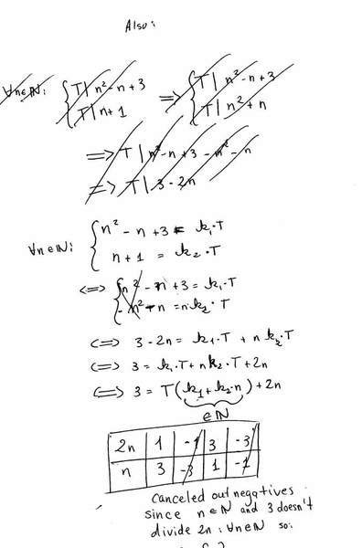

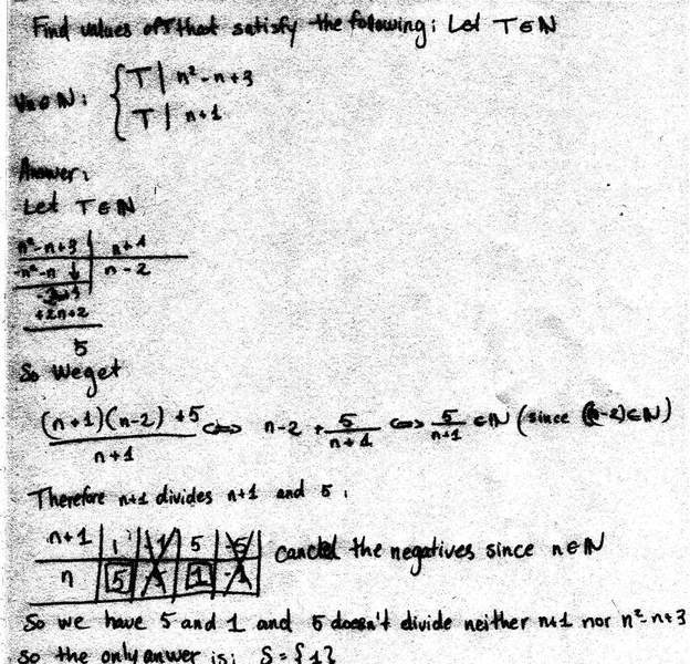

Look at my work in the picture.
I did a different method and I got 3 and 1 and still 1 is the only T that satisfies.
Your photo is very difficult to read. Also, what is the statement you are trying to prove?
I'm trying to find all values of natural numbers T that satisfy T l n^2-n+3 and T l n+1
Take a look at this copy and the bottom is cut off. It is S={1}
Mark44 said:
If n = 4, n + 1 = 5 and n^2 -n + 3 = 15, so 5 is in the set.
mtayab1994 said:
Yes, but it's not true for EVERY n in N. Aren't I correct?
Notice that I said "If n = 4".
Here's your problem statement from post #3.
There's no mention of "for every n."
Yes it divides it but not for every n.
