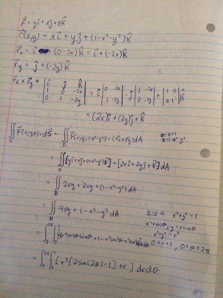

Mathn00b!
Hello,
So I've got to evaluate a flux integral, but I get 0. Could someone please, check my workings and give me advice.
Please find my workings and the problem attached here as an image.
Thank you very much!
I will give you that your handwriting is pretty nice. Still it would be better to type your work. Is that third component of your flux vector a ##z## or a ##2##? Some mathematical issues are: Is your normal directed upward like it is supposed to be? In fact, is it even a vector? That's another reason to type your question, so we can edit it. Also you can't say ##x^2+y^2=1## for the normal. That is only true on the boundary of the surface but not on the surface itself. And check your partial derivatives.
You can parametrize the surface if you want, let:
$$\vec r(x, y) = x \hat i + y \hat j + z \hat k = x \hat i + y \hat j + (1 - x^2 - y^2) \hat k$$
Find ##\vec r_x(x, y)## and ##\vec r_y(x, y)##. Use those to obtain ##\vec r_x \times \vec r_y##. Now you have a theorem which states:
$$\iint_S \vec F(x, y, z) \cdot d \vec S = \iint_D \vec F(\vec r(x,y)) \cdot (\vec r_x \times \vec r_y) \space dA$$
Where the region ##D## is given by the plane ##z = 1 - x^2 - y^2## for ##0 \leq z \leq 1##.
Plotting the plane for the points ##(x, 0, 0), (0, y, 0)##, and ##(0, 0, z)## will give you the limits easily, and a nice graph to look at.

The ##\pm## sign is necessary because one has to decide whether ##\vec r_x \times \vec r_y## points in the required direction to agree with the given orientation. The OP didn't check that.

Hello, I've got exam on the same things, so please give some feedback on my workings
This surface is the graph of the function [itex]f(x,y) = 1-x^2-y^2 \mbox{ for } x^2+y^2 <= 1[/itex], so use the graph parametrization
[itex]X(x,y) = (y,x, 1 - x^2 - y^2).[/itex]

Sorry for that a bit earlier where I mentioned ##z = 1 - x^2 - y^2## is a plane, it's a paraboloid.
As for the actual question, I worked it out to be:
Sorry for the squeeze near the bottom I was writing a bit too quickly and it got cut off.
As for the actual question, I worked it out to be:View attachment 83290
Yeah, I got the same, I just played it smart, but I think your solution is correct. I substituted r = x + y in the integral ## 1 - x^2 - y^2## with ## 1 - ( x^2 + y^2)## to get ## 1 - r^2## and also for x and y since r = 1 I think I saw somewhere to replace ##rcos( \theta ) ## with ## 1cos( \theta )##
Otherwise your should be the correct one.
