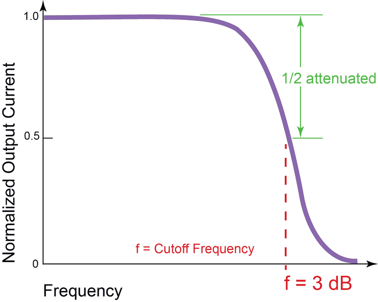

The word "allowed" is where your problem lies. The bandwidth of many signals can't necessarily be stated in a simple way that you are implying. Take any phase or frequency modulated signal. Its spectrum can extend to infinity but no receiver is designed to accept the whole spectrum - for obvious reasons.
It's a convention that the half power point (or difference between the two for an RF modulated signal) defines the bandwidth. Truncating a signal will introduce distortion but it's 'sufficient' to define it that way.
For any signal transmission exercise, the Noise that's introduced is always relevant so you have to balance out the distortion, resulting from truncation of the spectrum against the noise that's admitted by any filtering. In practice, the 3dB bandwidth works fine. Many references sort of assume that.
