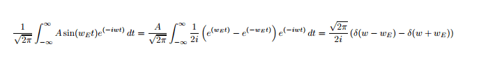

I'm a little unsure of how the attached solutions are obtained. For instance one of the Fourier integrals is:
∫e(wE-iw)t = [1/(wE-iw)e(wE-iw)t from -∞ to ∞. But what do you do about the real part wE? That leads the integral to diverge as far as I can see...

hizezima1! :smile:
those ewEts are a misprint, they should be eiwEt :wink:
