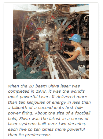

Assuming that I understand your question, it is more common to amplify a laser beam to make it stronger. Here is a website that describes how they do such beam amplification at the Inertial Confinement Fusion facility in Livermore, California:
https://lasers.llnl.gov/science/icf/how-icf-works
