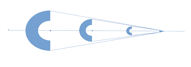

  • #122
This is what I think the wave fronts should look like.
Backward propagation can probably be approximated as spherical with significant doppler shift. Forward propagation is at the speed of the aircraft so all forward waves are coincident.
Now I have put a straight line between the two which is clearly not accurate but gives an idea. I can't be bothered to make a research project out if this .
All depends upon correct calculation of that part. Immediately around the nose cone it will be the mach bow wave, and I suspect this is the case going out from there too.
If there is some space between the lines, as in my clumbsy hand drawn graphic, that would leave open the possibility for backwards sound. I'm NOT suggest that is the case with this graphic. I don't believe that is the case. But I don't think we can be more definative without doing some serious work, which would be interesting but I don't have the time to do.

  • #123
A.T. said:
The front shock contentiously propagates at the speed of the aircraft, because it contentiously has the aircraft behind it compressing the air. A short explosion shock at the side has no such reason to propagate at the speed of the aircraft.
That's betting thinking. But the shock wave is not just directly in front. It is the mach cone. Everything inside the mach cone is going progressively more slowly as a non linear function of the ( normal? ) distance from the cone surface. The shock front will reduce to propagating at mach as we look further back along the cone.
Sound just inside the cone will be severely doppler shifted. Sound propagating perpendicular to the line of flight will not; and backwards will be doppler shifted to lower.
I still don't see much proof or demonstration of a reversed sound effect but it is not possible to be definitive on the basis of hand-waving thought exercises such as this thread.
  • #124
Try figure 4 here:
https://www.researchgate.net/publication/230702229_Reproduction_of_Virtual_Sound_Sources_Moving_at_Supersonic_Speeds_in_Wave_Field_Synthesis
