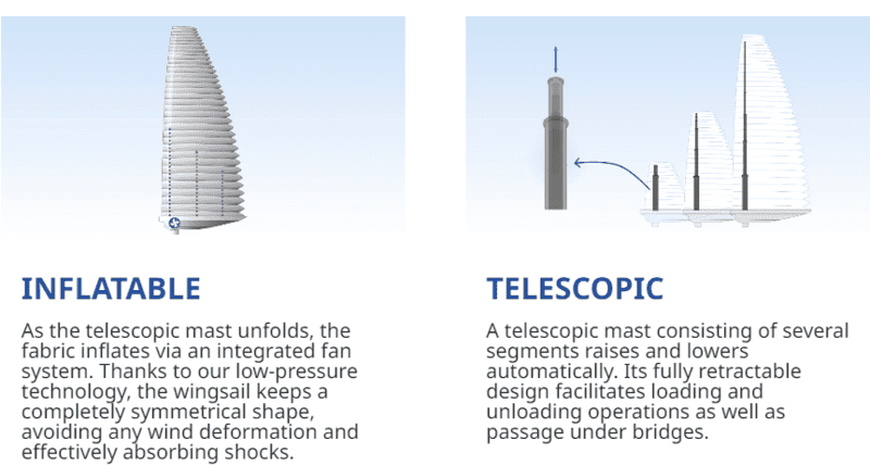

WISAMO from Michelin — its name is a combination of the words wing, sail, and mobility — is an inflatable, retractable, and automated wing sail. While it's not intended to replace ships' engines entirely, it lightens their loads and decreases their dependence on fuel. According to Michelin, the company that manufactured the design, the goal is to cut carbon emissions by up to 20% for existing ships and up to 50% for newly-built models.
I expect the sails and mast would have to be retractable in order for the ship to pass under some bridges, or they will be restricted from some harbors, or they will be limited in height above the sea level.
The Francis Scott Key bridge had a clearance of 185 feet (56.3 m).
Golden Gate Bridge has a clearance of 220 feet (67 m) and the Verrzano Narrows Bridge has a clearance of 228 feet (69.5 m).
Apparently, the mast(s) will be retractable.

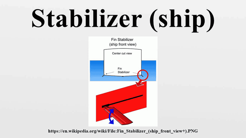

And they have other ways of mitigating heel.
The problem is that the heel moment, is being applied with a long lever arm on a container ship. They are already operating at the stability limit, just within the profile of the canal width and depth, and the bridge and crane clearance.

From the article
the IWS inflates via an integrated air compressor to a surprisingly low pressure, just two millibars.
It creates a soft, symmetric wingsail with many of the efficiency advantages of a hard wingsail (amply demonstrated in America’s Cup and SailGP racing) but none of the problems – it’s very simple to raise and lower, and just disappears down to the deck when you don’t need it.
Two pascals, is the ram air pressure at about 6 kph.
I expect one side of the leading edge of the sail will then collapse inwards.
There are things we are not being told.

There are no big vessels using the system. There is one small demo vessel on Lake Geneva? There are many more artists impressions.
Tension in the sail fabric comes from internal pressure and mast extension. There seem to be "floors" or "decks" with apertures, built into the sail, that control the profile.
It seems to me that the dynamic external pressures on the sail, must be less than the internal pressure. Maybe 2 Pa is the minimum without wind, and it is increased by higher wind pressures through the front inlet duct, boosted by the fan. But then the entire volume must be under a pressure greater than the maximum external pressure.
I do not see a big conspiracy, just a lack of solid information in the stream of publicity.

But a ship needs to have protection from gusts of wind when it is going slowly or when the engines fail (which is the issue in this thread. Stabilisers on container ships are to protect rolling forces on deck cargo. The effect on a sail is additional; more lateral forces. A sailing yacht has a massive keel, well below water level and can heel to a ridiculous degree but still recover. That's not like a container ship with so much mass high up.
The amount of active stabilisation needed with sails would surely be a lot higher, which would have knock-ons for the overall design. You'd need to show that the stabilisation would be adequate under all conditions to make it safe and worthwhile. Beyond our pay grade, I reckon.
If the sailing mode could be de-activated quickly and easily then stability might not be so much of a problem - of course. But then, what proportion of a voyage would benefit from wind power?

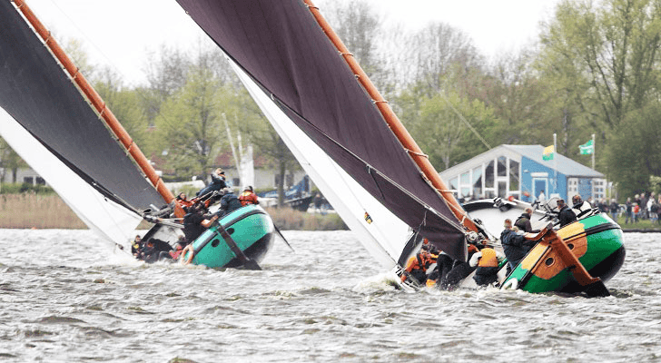

I think you are underestimating how stable a flat bottomed ship actually is, just as an example, this is fine:
These ships have no keel, to be clear.
Also, the height of the center of mass isn't as high as it looks. That there is a lot of volume high up doesn't mean the mass is as well. I don't think stability is much of an issue.
But each of those boats has two leeboards, the high side is showing, while the lower leeboard is deep in the water, under the vessel.
Those hulls are not loaded with cargo, and are not flat-bottomed when sailing unladen in that heeled mode, they are taking advantage of the chine and one leeboard as a keel, to minimise section, to gain speed. If they were loaded, there would be no freeboard, and they would have to limit the heel to a couple of degrees.

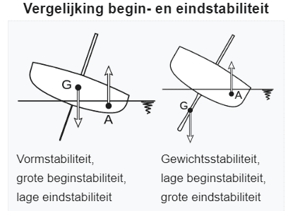

A leeboard does nothing for stability, if anything they decrease it because together with the sail they form the heeling moment. Removing the leeboard actually reduces the heeling moment because the lateral resistance point moves upward (although I wouldn't use that as a method to prevent capizing...). The leeboard is only there to prevent leeward motion (sideway motion, drift) The chine technically does as well, although the soft chine in this case does a lot less to prevent this.
These ships are 'form stable'. I'm unsure of this translation to English, Dutch is 'vormstabiel':
Left picture is 'form stable' typical for the flat-bottomed ships I showed in the picture, as for most merchant ships. Here the center of gravity is higher than the center of buoyancy. Right is 'weight stable' (again, unsure of the translation), typical for yachts, where this is reversed.
Cargo actually makes the ship much more stable since the righting moment becomes much larger for equal heel. The total heel they can have may be somewhat less if you have less freeboard, but sea-going ships have a high freeboard anyway, that's not going to be a limitation there.
