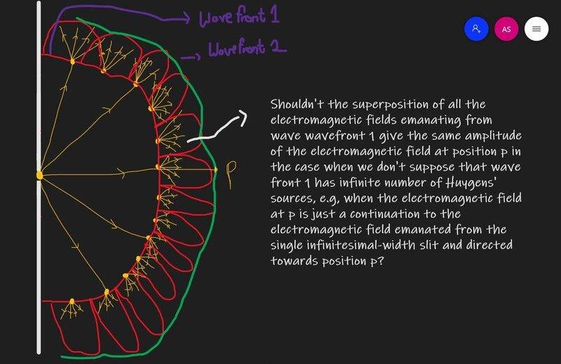

In a single slit diffraction experiment, when we want to calculate the intensity of light on a screen located very far away from the slit, usually Huygens' principle is adopted as a model to perform the calculations.
It is assumed that the width of the slit consists of an infinite number of Huygens' sources, where each Huygens' source is a source of electromagnetic radiation that spreads in all directions. The interference of all the electromagnetic radiation emanating from all the sources creates the diffraction pattern that we see on the screen.
But what is confusing me is that the principle is only applied at the wave front that is present at the slit.
For example, suppose that the single-slit has an infinitesimal width. Therefore, the slit itself would be a Huygens' source. The Huygens' source will create a wave front and this initial wave front contains infinite number of Huygens' sources, and all of these infinite number of Huygens' sources will create their own wave front and so on.
I think in all textbooks, they don't take the electromagnetic field emanating from the other wave fronts ( the wave front that is not present at the slit) into account in summing up the electromagnetic radiation to get the intensity at a certain position. Shouldn't we take them into consideration to calculate the intensity? or is there a proof that the superposition of all the electromagnetic fields emanating from wave wave front 1 creates electromagnetic field at position p (on wave front 2 just after wave front 1) with an amplitude just equal to the amplitude of the electromagnetic field there but in the case when we don't suppose that wave front 1 has infinite number of Huygens'
sources, e.g., when the electromagnetic field at p is just a continuation to the electromagnetic field emanated from the single infinitesimal-width slit and directed towards position p?
See the attachment below for more clarification to my question.
Yes that is correct. But remember these are lines of a particular phase on the wavefront and these lines are typicaly curved. At the point that the curve is complicated then the construction is not a simplification. Nor do these sources necessarilly have the same intensity as the original or each other.
This is not an assumption. This is the requirement for the experiment. The light must be from point source far away (i.e. a "plane wave") or the equivalent. If the light is different Huyghens requires a different source. You don't just assume.

amjad-sh said:
You are describing the quantum mechanical point of view of diffraction of light, and my question is just related to Huygens' principle.
Huygens' principle comes from Path Integral in QM. So you have questions on it you can get deeper understanding by investigating Path Integral.
Yes I know that the sources on a wave front do not necessarily have the same intensity, but my question is that Is the intensity at a specific point p on an arbitrary wave front k, in the case when the wave fronts (other than the initial wave front at the slit) contain Huygens' sources, the same to the intensity at that specific point p on an arbitrary wave front k in the case when the wave fronts don't contain any Huygens' sources?
I guess that they would be the same, because otherwise there would be a flaw in the way the principle is used to calculate the intensity of light on a screen located very far away from the slit. Because in most sources that I have read they state that only the wave front on the slit contains infinite number of Huygens' sources and ignore that the other wave fronts have also Huygens' sources. So, for their formulation to be correct, the two intensities must be the same.
I think it is a requirement for the Huygens' model. Huygens' principle states that "all points of a wave front of light in a vacuum or transparent medium may be regarded as new sources of wavelets that expand in every direction at a rate depending on their velocities".

I can notice that the integral formula is applied when the time t is fixed. I mean, for example, if we consider the wave front at the single slit, all the points on the wave front at the single slit will be regarded as sources and using the formula the amplitude ##\Phi_0(\vec{x})## of light wave of any phase can be calculated at any position away from the single slit at fixed time t. We can also consider another wave front different from that present at the slit ( the points at the wave front located at the single slit would not then be considered as sources though). In this case, all the points located at that wave front will be regarded as sources and using the formula we can also calculate the the amplitude ##\Phi_0(\vec{x})## of light waves located at any positions beyond that wave front. But, as @hutchphd mentioned in post #3 the wave front not located at the slit may be curved in a complicated way. Therefore, the sources will be located in a wave front of complicated surface. Therefore, the easier choice would be to consider the wave front at the slit because its curve is known and not complicated (linear).
Now in case my analysis above is true, I still have some uncertainties related to Huygens' principle.
1- Suppose that at time t the plane wave just reached the slit and haven't yet moved beyond the slit, and we want to calculate ##\Phi_0(\vec{x})## beyond the slit, can we still use the formula to calculate ##\Phi_0(\vec{x})##? I mean if we want to calculate ##\Phi_0(\vec{x})## beyond the slit at time t'>t, and provided that the waves emanating from the sources are propagating with the same speed c, some of the waves my reach position ##\vec{x}## at time t' but some would still can't reach this position at that time. So, how the formula would be interpreted in this case?
2-From this formula it seems that the waves are emanated in all directions from the source, but according to Huygens' principle the waves only emanate forward from the sources and not backwards. So, do we need to impose this assumption on the formula?
3- Does the wave fronts beyond the slit need to be spherical, or they can have any arbitrarily complicated shape?
