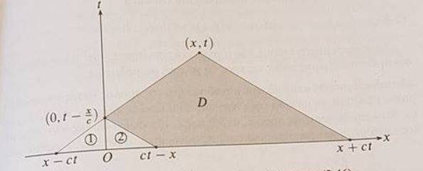

I want to verify that $$w(x,t)=\frac{1}{2c}\int_0^t\int_{c(t-\tau)-x}^{x+c(t-\tau)}f(y,\tau)dyd\tau$$ is the solution of the problem $$w_{tt}=c^2w_{xx}+f(x,t) , \ \ x>0, t>0 \\ w(x,0)=w_t(x,0)=0, \ \ x>0 \\ w(0,t)=0 , \ \ t\geq 0$$ For that we have to take the partial derivatives of $w$. But how can we do that in this case for example as for $t$ where we have at both integrals the $t$ ? Could you give me a hint? (Wondering)

Are maybe the limits of the limits wrong? These limits should describe the following set:
Are the limits that I used at the integral of $w(x,t)$ correct? (Wondering)
I believe you've already found that it should be:
$$w(x,t)=\frac{1}{2c}\int_0^{t-\frac{x}{c}}\int_{c(t-\tau)-x}^{x+c(t-\tau)}f(y,\tau)dyd\tau+\frac{1}{2c}\int_{t-\frac{x}{c}}^t\int_{x-c(t-\tau)}^{x+c(t-\tau)}f(y,\tau)dyd\tau$$
It also means that some of the steps are not correct yet. (Thinking)
