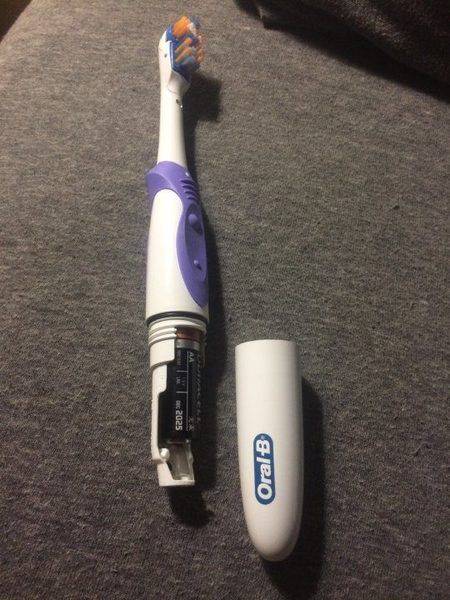

So as you can see the battery can be held in without the cap due to the design and can also operate without the cap screwed in place and yes I would like to do it non-invasively or rather without drilling holes in it haha. But I would like to know what you think would work as far as testing the voltage while it runs and what to test the voltage with?

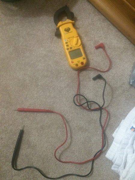

So I have a multimeter and my toothbrush
good :)

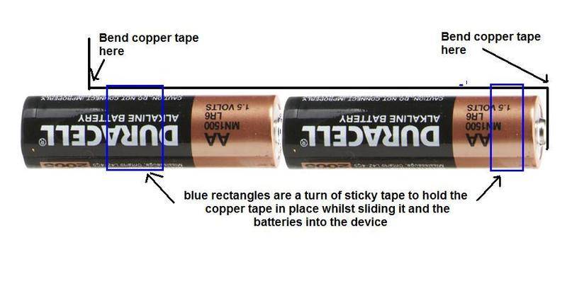

stephencockmon said:
but I don't know how I'll be able to touch the red (positive) chord to the positive end of the battery while it is inside the toothbrush or if that's what I'm even supposed to do?
that's what the copper strip is for that berkeman was talking about
set it up like this have drawn a nice pic for you :smile:

Alright so where does the other end of tape lead to? And it's actually just 1 battery thankfully so less waste.
The left end, the one bent up is where you touch the positive lead probe tip of your multimeter to
the negative lead probe tip of the meter you can place against the negative end of the battery(ies) there will be a coil spring there just like in that battery holder berkeman had shown you
I had shown 2 batteries as that's what you said in your opening post :wink:Dave

True haha that was my bad guess, but much thanks, I'll be testing and I'll probably let you guys know how it goes, thanks again guys!

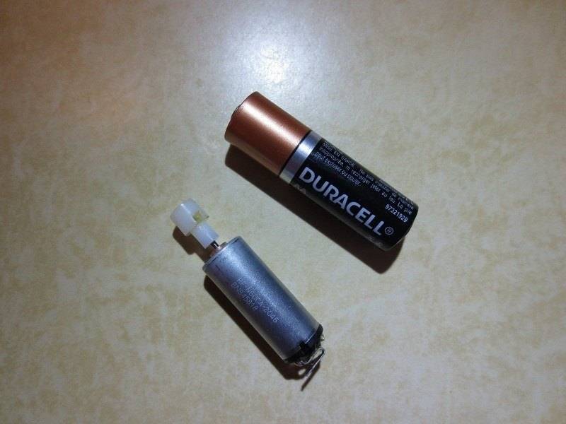

Doesn't this tooth brush only have one AA battery? I recently took apart one like this to get the motor and it only had one battery.
edit: oops. davenn beat me to the 2 battery thing.

Nice DMM! What model is it? It looks like it has an AC current sensing loop, but the toothbrush current will be mostly DC.
You can make measurements of the DC and AC voltages once you get the probe points on your battery figured out. Keep in mind that as a battery discharges, its characteristics change a bit. You should look around at the Duracell website to find a datasheet for the AA batteries you will be using in your project. :smile:
It's my associate pastor's actually, he's a cool guy and he's my friend's dad haha

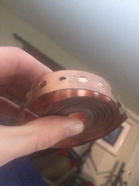

I don't have a soldering iron, can I not just apply the tape to the tip of the probe of the mulimeter?
Would this work?
Would this work?View attachment 96466
looks pretty heavy gauge, it may or may not fit down the thin gap between the battery and the housing ??
if it fits then use it :smile:
Since copper is such a good conductor (electrically and thermally), it would probably effect his intent of
... testing the effects of temperature on batteries.
