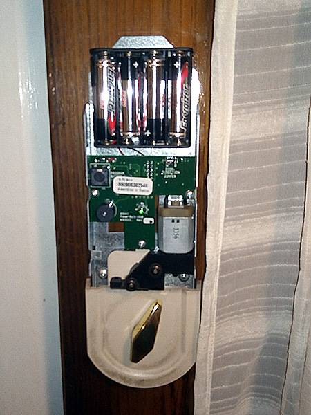

My battery-operated door lock will not work with any other batteries than those in it now.
I am mystified. My number-combo door lock (one of two I have) is powered by 4 AA batteries. It has been working for so long I don't remember when I installed it - musta been ten years at least. The batteries have begun to run down - it labours to retract the dead bolt now - so it's time to replace them, as I do every year or two.
Grabbed four identical batteries out of the same box as the ones currently in the device (same expiry date - ten years from now). New batteries do nothing - device does not work. Will not light up the LED or beep or anything. Presumably, batteries from box are stale?

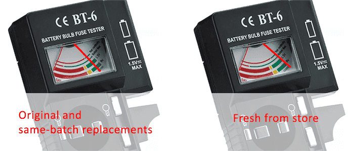

Battery meter says no, batteries are fine. I accuse battery meter of lying and go back to old batteries that still work - barely.
(I know these types of meters are not very reliable for absolute values, but I get pretty good values for relative comparsion.)I go out and buy a fresh batch of batteries - same brand (Energizer), but these one I notice are "Max" (I guess they're heavy duty). No joy. No light, no beep, nothing.
I try the original batteries, which work every time, even though slowly. I flip back and forth between originals, old replacements and fresh-from-store a dozen times. Results are exact: Originals work 100% all others work 0%. Combinations of old and new result in 0% - IOW, only all four original batteries work.
That being said: I can get replacements and fresh-for-store to work temporarily if I apply pressure by jamming my hand on the batteries.
As far as I can determine, it isn't oxidation on the contacts, or a bent contact, or weak batteries, or anything like that. I've tried six ways from Sunday.
My best hypothesis is that the device refuses to operate if the voltage/current is too high - except why does it work if I jam my hand on it?
Thoughts?

In my experience it is always the positive end of the AA battery (the protruding end) that is the issue. I think many devices recess that battery contact in the case to inhibit effect of wrong way insertion.
Because you can get contact by mashing it may be sufficient to insert the batteries and close all the retaining doors, making the plastic box more rigid. Smack the box sharply with the battery doors closed to see if you can "settle" them onto the contacts. And those battery testers work fine IMHO.
If you have a meter put it on V and check the voltage at each junction: black at - end and poking each in turn...you should get 1.5V,3V,4.5V,6.V.
I agree. The buttons on the (+)ve end of batteries have become lower profile over the years, and the plastic around the holder socket has become thicker. Carefully reduce the battery holder plastic at the (+)ve end, to allow the battery to make contact, or insert a thin metal shim to make a contact if there is sufficient length in the holder.

I used a ball of aluminum foil to make a shim in such cases. The battery can crush it to the needed size.

If it works, great. I use a bent bronze shim and avoid Al foil because Al has a sapphire coating and will corrode to crumb in marine environments.

So the positive-terminal shroud on the battery-holder needs to be less than 1 mm deep to meet that spec. There also needs to be a minimum length of 1.3 mm spring in the holder.
1) Another (remote) possibility is that your device actually needs Carbon/Zinc (LeLanche) cells. The fresh open-circuit voltage is slightly higher than the now-common Alkaline chemistry. The Carbon/Zinc cells are frequently labelled "Heavy Duty" without the "Alkaline" labelling.
I have an old RCA VTVM (Vacuum Tube Volt Meter) that uses a 'D' cell for resistance measurement. The Resistance range will not Zero with an Alkaline cell, but works fine with a Carbon/Zinc cell.
2) Another possibility is the battery holder having a bad contact. Those holders that have a rivet as a contact sometimes are loose or have a bit of hidden corrosion under the rivet head. If you are adept at soldering, a bit can be added to bond the rivet to the associated conductor, without melting TOO much plastic.

I'm with the short +ve nipple suspect. I have routinely had this problem with rechargeable AAs where they seem to shave that nipple height right down to the spec minimum to get a bit more volume in the body of the cell.
You need to put the batteries in then, with it 'on' probe back from the power tracks to see where the power 'stops'. Often, when you insert the probe onto the +ve end the thing starts because you've just closed the connection to the terminal.
