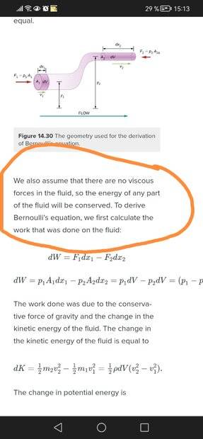

But I still don't understand what causes that ##\F_2## because it's not viscosity and if the pipe is at the same height all the time than there is no gravitational force either.

If Euler's differential force balance equation for an inviscid fluid is dotted with the fluid velocity vector, Bernoulli's equation automatically emerges. This is the mechanical energy balance equation for an inviscid fluid.
  • #33
So, the Euler differential force causes ##F_2##?
edit: I mean, the bernoully equation is consequence of Euler diff. force balance eq...?

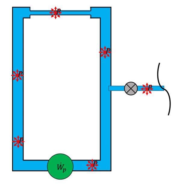

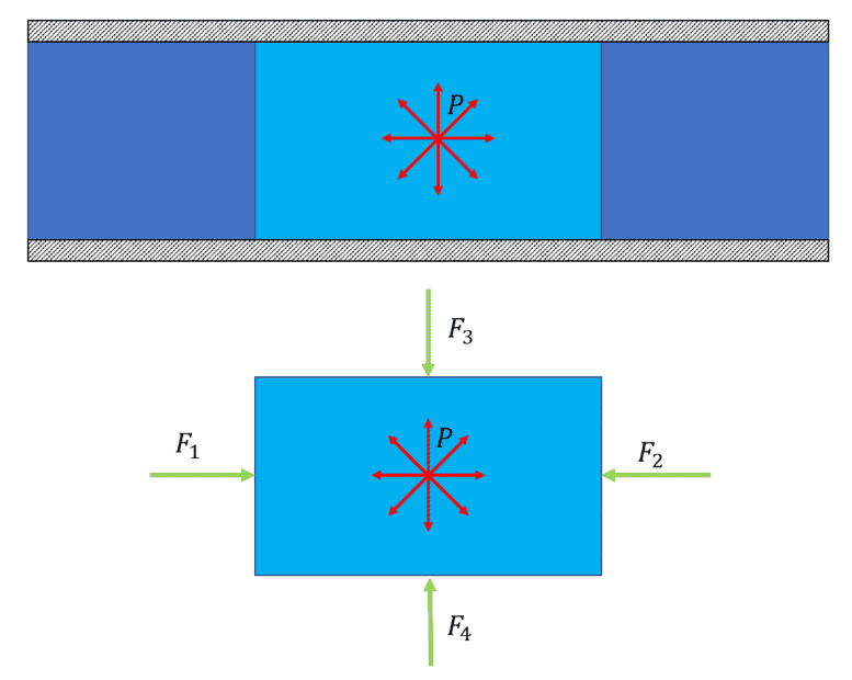

The fluid element is being compressed by its container and the fluid surrounding the element. It's under pressure. Thus, when we isolate the element from its surroundings to analyze it, we need to replace the effect of the surroundings as external forces acting on the element. The net effect of all those forces (and others not shown-like weight) dictates whether or not the element is accelerating in a particular direction.
When you first started this, I was thinking you were seeing some seeming contradictions that can arise in certain systems where Bernoulli's gives spectacularly unrealistic results because of the inviscid assumption applied to an entire system. But, it just dawned on me (when you kept asking about ##F_2## and mentioned about calculating it in high school) that you probably just don't understand how we apply Newtons Second Law to analyze fluid systems. The average Mech. Engineers don't get into fluid mechanics until sophomore\junior year in college (I think). Sorry, If I caused any confusion in that regard. So lets back up, and I think we can get this resolved.

Imagine that parcel of fluid were instead a spring inside a non-rigid box. The fluid surrounding that package is under pressure. Its pushing on the boundaries of the box which contains the spring. The spring is being compressed. If we take the spring out of the fluid would decompress (expand). So...if we are going to analyze it as it were inside the fluid, then outside the surrounding fluid we need to apply forces to the spring to keep it in its compressed state. When we isolate a system, this is what we are doing. We are removing everything around that system, and replacing what everything does to that system with forces.

Regarding discussed F1 and F2, independent from the source that induces that imbalance, they must exist if the fluid is moving in an accelerated manner.
If the fluid is static or moving at constant speed, F1 - F2 = 0.

Then that should answer your question about the existence of ##F_2##?

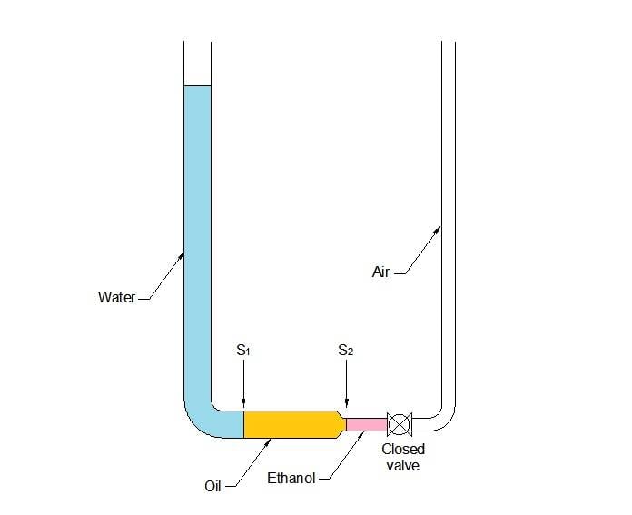

You can have a U-shaped vertical tube with a closed valve that keeps a height differential between left and right columns.
For that set up, fluid is not moving, therefore it has no dynamic energy, only potential and pressure.
After we suddenly open that valve, the volume contained between the two columns (the U of the arrangement) will be feeling a different amount of pressure between left and right ends or cross-sections.
That pressure differential will tend to naturally get balanced (due to energy loss through friction and turbulence), but it will give impulse to our volume of fluid initially inside the bottom of the U tube.
