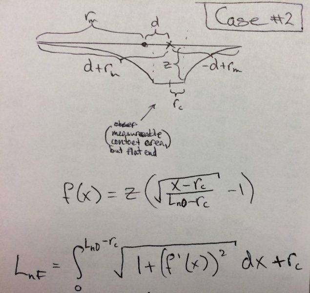

Chrono G. Xay said:
I just realized that the diagram you drew earlier doesn't include the distance--if any--between the center of the membrane and the center of the contact area...
Yes. That's correct. I assumed that the contact ring on the probe moved vertically downward without causing significant additional stress (over and above the preload stress) in the membrane. That's the same approximation we make when we analyze a preloaded guitar string being loaded transversely.
The rest of the membrane is within the contact patch under the drum stick.

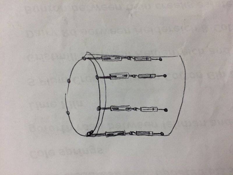

Here is a sketch of the apparatus:
After a little thought yesterday I realized that, even if still not correct, I could at least somewhat model what you drew earlier, including the distance when the center of the area of contact and the center of the membrane:
I like the experimental setup. To get the preload stress, you would have to determine the tension on each cable, and divide it by the arc length subtended (1/6 the circumference) and by the thickness of the membrane. This will only give you an approximation to the stress. To get a better approximation, you would need to use smaller arc lengths and more cables.
As far as your equations are concerned, I'm not able to follow what you did and I don't want to spend too much time because I'm pretty sure that they are not correct. But, I have figured out how to complete the analysis that you are interested in and will be presenting it to you later. But, in the spirit of how we do things at Physics Forums, I will only present some of the key initial equations, and then work together with you in deriving the final results. How does that sound?

I like the experimental setup[, but] [t]his will only give you an approximation to the stress. To get a better approximation, you would need to use smaller arc lengths and more cables.
How about if I used a stronger steel rim for applying force, so that it deforms less under the same stress? (Also, I was too far into drawing the diagram to change it, but the actual drum I was going to attempt to simulate was a 14" snare drum, which typically has either 8 or 10 tuning bolts.) I've read on drumset forums that those who used them felt they were able to get a more even tuning, or had greater ease in the process.

I thought from your diagram that the rim was not providing any of the support. This is what I was hoping for.
The rim is there to help make sure the force exerted by each tuning bolt is kept as even as possible over the arc length of the circumference it affects. The stronger it is, be it from a stronger material or thicker walls of the rim, the more even it should be. Now... I could buy a regular rim and drill extra equidistance holes, but as incredibly inexpensive (~$13) as that would be compared to just getting a steel barrel of the needed diameter (~$300), let alone the number spring scales (depending on which range and resolution of force I'll need) and turnbuckles I'll need by default, that's even more money I don't have. Hahaha...
