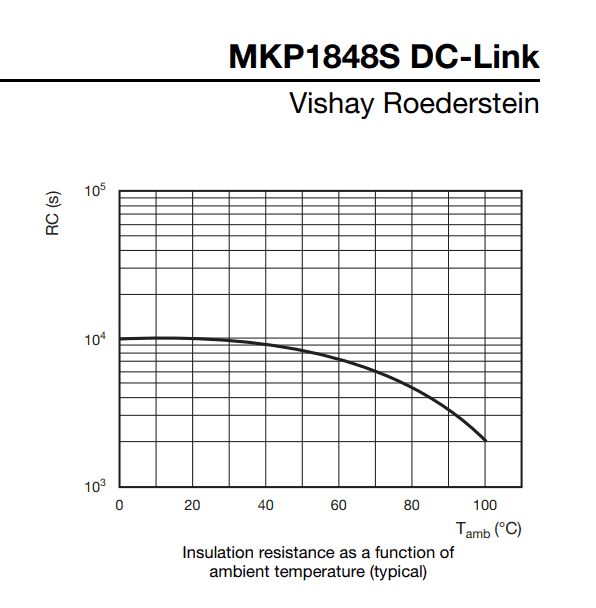

If I cannot find the leakage current specification, how would I go about selecting the balancing resistors then? It doesn't seem like it would be feasible to select the balancing resistors after measuring the capacitors. But going on that, would I apply a voltage simply measure the decrease in voltage to determine the parallel resistance and from there get leakage current?
I found a capacitor online that provides the insulation resistance. I've attached a pic here, but I'm not sure how to even use it.

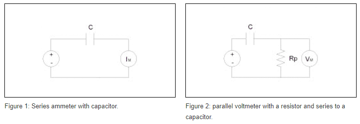

That's for your answers. I just though about this and let me rephrase this. I didn't realize that there was anything more to it than putting large resistors in series/parallel with capacitors to distribute the voltage evenly. I didn't know it had anything to do with leakage current. I'm still not sue exactly how to design around that parameter, but first I guess I should figure out my leakage current. That should not be a problem as I already have a few of the capacitors that I'll be using.
I've attached an example I found online discussing how to measure leakage current. It said the ammeter in series with the capacitor is usually used for low value capacitors typically 1uF or less. Mine are 6 uF so based on this I should use the parallel voltmeter configuration. The challenge I see here is I would need to measure dv/dt, right? I'll need the capacitance value too and even that could be off +/-10%. I guess that's not a big deal since it would just translate to an insulation resistance of +/-10% which should be considered in the design anyway. Do I use a large resistor sever Mohm to prevent it from discharging, or how do I size this resistor?
https://product.tdk.com/info/en/con...here are two basic ways,source (See Figure 2).
No. Leakage current is a DC measurement. Use a DC source that has dV/dt=0.

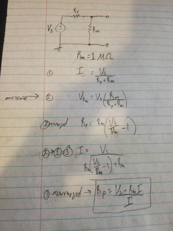

I've drawn the circuit and equations that I think that I should use. Does this approach look correct?
Vs = source voltage
Rm = measurement resistance (external resistance used to measure voltage)
Rp = parallel resistance of capacitorOnce I get the leakage current, I'm not sure what to do next. I simply make the resistance or each balancing resistor ~10x lower than this value?

Hi Will, I just looked at the datasheet you linked to and have a few comments.
The style capacitor you have in mind seems to be available for up to 1200Vdc max at 85C. If the maximum temperature does not exceed 70C, it can live with 1440Vdc. That is probably enough safety margin for a "build one of a kind" or "experimenter" design. For production or long-life, I would choose to use five of them in series instead of four. Each of those five would be 12uF, instead of 9uF, to give the same total capacitance.
To find the leakage current, the graph you supplied (from pg 13 of the data sheet) can be used. It gives the time constant of the capacitors versus temperature. The time constant is the product of capacitance in Farads and leakage resistance in Ohms, with the result expressed in seconds; 10,000 seconds at room temperature.
With Time=RxC, and knowing time and capacitance, you can find the leakage resistance; R=(T/C). You then have R=((1x104)/(12x10-6)).
If I did the math correctly, the leakage resistance of a 12uF cap is 833 MegOhms at room temperature.
Using the graph on pg 13, at 50C the resistance will be 90% of that or 750 MegOhms.
Using a factor 10 for leakage current, a resistive divider for balancing would then consist of a 75 Megohm resistor across each capacitor. Unfortunately 75 Megohm, 1KV resistors are quite rare and likely expensive. For a single build you would probably use three 22Meg and a 10Meg in series across each cap. Those are standard value resistors and are USD $0.41 each at digikey,

willDavidson said:
I plan to use 4 series Vishay MKP1848C59010JP2 1.5 kV 9 uF capacitors found at the link below. I will be applying 1 kV across each.
From the data sheet.
Insulation resistance; RC between leads, after 1 min > 10 000 s
R * 9 uF = 10k sec;
R = 10k / 9 uF;
R = 1G111
You should use a maximum of 100 Meg as the balancing resistance across each cap.
The Yageo HHV series resistor maximum value is 68 Meg.
1 kV / 68 Meg = 14.7 uA; → 14.7 mW
Now, verify the resistor power and voltage ratings are in spec.
