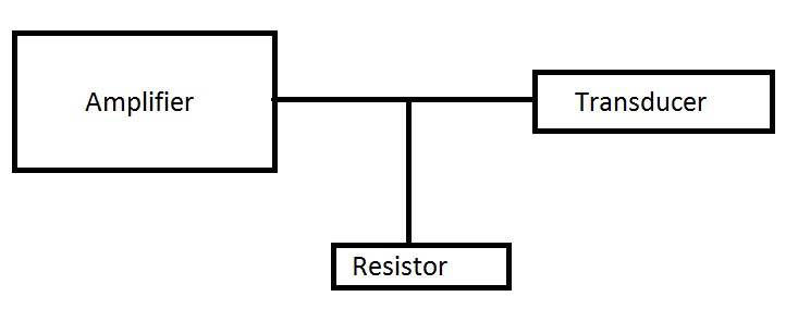

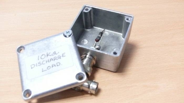

We kept getting some voltage spikes back into our amplifier. One of the things we put in place is a 10kOhm resistor (discharge load) connected to the output of the amplifier. However, the resistor keeps burning and setting on fire.
The amp company offered a way on checking this...
Measure output voltage from the amplifier. Then calculate V2 / R of the resistor and you may find you have dissipated more into R than it is designed for. The selection of resistor wattage for continuous operation should not dissipate more than 50% of it's capacity, lower if possible.

My question is where do I check the Wattage limit of my resistor? It's just a general resistor from the electronics lab.
A suggestion was to use a CADDOCK power film resistor which are 15W, 20W, 25W or 30W non inductive resistors with cooling tab, would this stop the thing melting?

In theory you take the effective voltage (the DC voltage that generates the same disspation in a resistance :smile:). For a sine, ##V_{\rm eff} = {1\over 2}\sqrt 2 V_{amplitude}##. However, many multimeters measure ##V_{\rm eff}##.
Normal resistors are 1/4 W or so. Not meant to dissipate power.
This kind of feedback to an amplifier (guitar amplifier or something ?) doesn't help much against voltage spikes. At least not if you have to turn up the volume to compensate for the power loss.
Oh, and if you blow a 10 k##\Omega## resistor, that means your voltages are considerable ! Be careful.

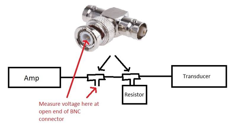

That's tomorrows job, I'm going to attempt measurement and thanks I see what you are saying, take the peak to peak voltage and calculate Vrms, I should have thought to do that, thanks!

Oh boy, definitely not a guitar amplifier :) and if it can pump 300 W into 50 ##\Omega## your spikes will be hefty alright.
At least no worries about the power loss from this resistor. (130 V)2/10 k##\Omega## gives 2 W so a 5 W resistor should last a bit longer than a small GP one from the lab. Wonder if you can find one. Else have two 22k ##\Omega## of 2 W in parallel.

Your biggest challenge may be finding a higher wattage resistor that is not inductive.

Yes that's a much better idea as I have to fit them into this box and soldering is not my strong point...

Digikey to the rescue!
http://www.digikey.com/product-detail/en/bourns-inc/PWR221T-30-1002F/PWR221T-30-1002F-ND/2360938
Among many. This is just the cheapest. You'll want to bolt it to a heat sink to get any significant wattage out of it.

Both need to be attached to a heat sink to have power handling capability. At your power level you could get a thermal silicone pad and bolt it to the case. Use the least amount of wire as possible.

no, because unless you bolt it to a heatsink ... eg. your metal case then it won't be able to dissipate as much heat
and if you are really using significant power levels, > 50W, then the case will need a finned heatsink and probably even a cooling fan
if you don't do that, the resistor will fry very quickly
that 30W resistor will most likely be good up to 60 - 70 Watts when only short pulses of power are applied and it is well heatsunkDave

Thanks, decided to go with the suggested resistor above, although just for initial testing, so I'll have the following...

The purpose of the 10 kΩ resistor is to provide a leak path for stored charge in the transducer isn't it ? Like the discharge resistor on a CRT ?

BvU said:
What came out ?
Ermm this didn't exactly go to plan, I decided to connect the oscilloscope directly to the amp (bad idea!) and the warning light came on as the amp needs a load present in order to function. So I'm going to have to do it this way...
So I've ordered the resistors and another T piece, just have to wait for them to arrive!
Yes, exactly! The problem is the piezo can discharge high voltages (especially when the amplifier is switched off) that have destroyed the MOSFET in our amp.
Nidum said:
Why does the resistor have to be 10 k ?
Why not for instance 20 k - that would produce only 25% of the heat from the 10 k one .
In any case I suspect that there are other and better ways of dealing with this problem .
Update, I understand this now. Basically the resistor is a high value so it doesn't drain anything from the amplifier and the signal goes straight to the transducer, the purpose is to discharge any static in the line. Therefore I need a bigger resistor, one that will not burn due to high powers from the amp.
