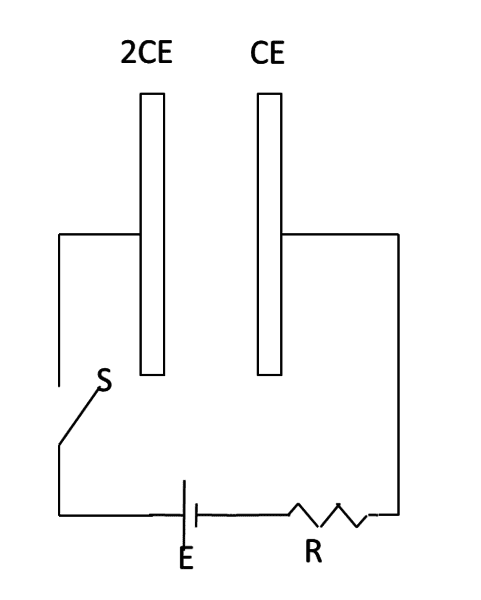

Plates of a capacitor have charge 2CE and CE initially. Now the switch S is closed. Which of following statements is true? Assume that the battery, resistor and wires do not have any capacitance.
A)There is no change in charge at outer surfaces of the capacitor.
B)There is no change in charge at the inner surfaces of the capacitor.
C)Charge flowing through the battery is zero.
D)Charge flowing through the battery is CE/2.

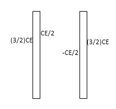

When the switch S is open, the charges rearrange as shown in attachment 2.
The set up is at a potential E/2 so some charge must flow to bring the capacitor at potential E when the switch is closed. The magnitude of final charges on the inner surface is CE. Hence a charge of CE/2 flows through the battery.
But I am unsure what happens to the charge on outer surfaces. I have no idea about what to do with them. :(

For arbitrary battery voltage, what general results can you deduce regarding the charges on the outer surfaces of the two plates? Remember that the electric field inside the conducting material of the plates must be zero everywhere.
Also, what happens to the total charge of both plates added together when the switch is closed?

Initial charges (from left to right): 3CE/2,CE/2,-CE/2,3CE/2.
If I assume that the charge on outer surfaces do not change, then final charges are: 3CE/2, CE,-CE,3CE/2.
The total charge stays the same but how to show that charge on outer surfaces do not change? I am sorry for silly questions. :(
Since the charges on the inner surfaces are equal and opposite, they add to zero. What must be the total charge of the two outer surfaces?
For the given case, it is 3CE.
Right. Since the total charge on the two inner plates is always zero, the total charge of the system is the same as the total charge on the outer plates. But, you know that the total charge of the system doesn't change when closing the switch. So, what can you say about the total charge on the outer plates when the switch is closed?

The battery moves charge from one plate to the other, but it does not store charge. So, any charge that leaves one plate and moves to the battery must be accompanied by an equal amount of charge that moves from the battery to the other plate.

Initially the potential difference across the plates is E/2 (that is because of the inner charges). As the battery is connected the charges CE/2 will flow through the battery to make inner charges +CE and -CE and the potential difference E between the plates, equal to the emf of the battery. the charges on outer surfaces remains unchanged.
