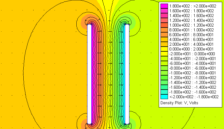

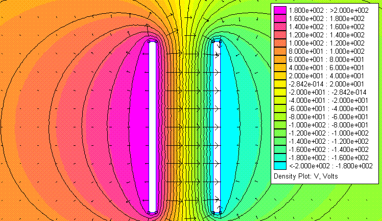

Okay thank you. I am asking about this because I am trying to model the electric field of a simple capacitor using this FEA program called FEMME. And When I setup the model, if I draw the plates of the capacitors as thin rectangles, I can specify the voltage potential on the lines that represent the rectangles but I am a little concerned about the results it is giving me. If I specify the voltage potential all around the border of the plate, then it shows an equal e-field potential around the entire plate, but I am not sure if this is the case in real life. I attached two screenshots of the simulation I did. The first one shows the charged plates with the complete borders having the potential. The second screenshot is the same as the first except that I only defined the inner two border lines with the potential. Which diagram is more accurate?
In real life, you sometimes have to take into account the wires going to the capacitor, as well as its relation to its suroundings.
Particuarly at high frequencies.
i am not sure what you mean by "inner two border lines" of equal potential. (?) what those two lines looklike is a matter of a threshold and scaling. you can make that drawing on the right look different (big equi-potential line gets even bigger - more outa the picture and little circle even tighter). i am assuming that there is a scale change in the "x" axis (perp to plates) that is not reflected in the "y" direction.
if you were to keep the "x" and "y" scale equal, as the plates get bigger and/or closer (assuming they're perfectly flat and parallel) the less you will see of the edge effect. of the two pics, i don't know that there is a less accurate. they both look legit to me.
In a static situation (no time dependence of the charge or the fields), this should be correct. As you may recall, in electrostatics the potential is the same everywhere on the surface of a conductor. If the potential were not the same, (positive) charges would start to move from high potential to low potential, and the situation would not be static any more! :biggrin:
In real life, a capacitor is often used in situations where the charges and fields are not static (e.g. when you put one in an AC circuit), and then it is may not be safe to assume that the potential is the same everywhere on the surface.
