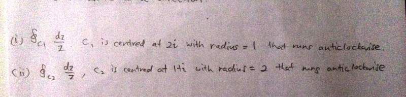

Hello.
How do I start this question? Do I use Cauchy.riemann integral theorem? or Cauchy.riemann integral formula?
  • Handwritten complex contour integrals: (i) integral over C1 of dz/z, where C1 is centred at 2i with radius 1 and runs anticlockwise; (ii) integral over C2 of dz/z, where C2 is centred at 1+i with radius 2 and runs anticlockwise.
There are many ways to find the integrals. The key point is if 0 is inside the given circles of outside.
What is the value in each case (0 is inside and 0 is outside)?
For C1 and C2 is 0 inside or outside?
The first one : 0 is outside the circle while the second one is inside. Am I right? Why do we have to know this?
^You do not have to know, but it helps. Do the integral for any circle centered at the origin. What is the value? That will be the same value as any closed contour that has 0 inside it.
1/z has a pole at z=0
Integrating around it will not be zero.
I am not sure how far into your class you are. That might be a new fact.

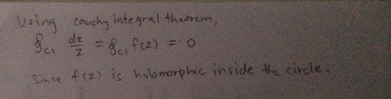

Ok, I just re-read again about Cauchy's integral theorem and this is what I got. I hope I have understood it right. Please check my solution for each question.
  • Handwritten working: 'Using Cauchy integral theorem, ∮C1 dz/z = ∮C1 f(z) = 0. Since f(z) is holomorphic inside the circle.'

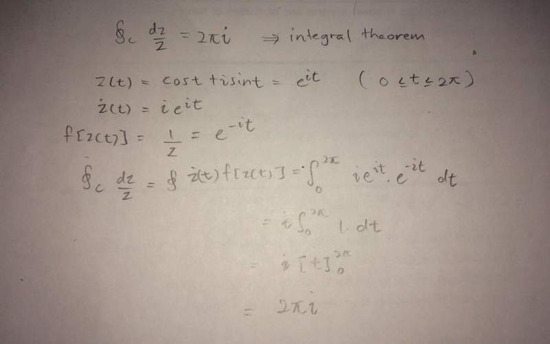

  • Handwritten derivation of the contour integral of dz/z around a closed path C equal to 2πi, using z(t) = cos t + i sin t = e^{it} for 0 ≤ t ≤ 2π, leading to i times the integral of 1 dt equal to 2πi.
^That looks good. For (ii) you should mention that you have changed the path without crossing z=0.
The pole (for 1/z) is always at z=0. The important thing is to know if z=0 is inside the circle or not. As you have said it is not for (i) and it is for (ii). Again I do not know what theorems and methods you have covered so far. You can calculate the two integrals by parametrization for example. The integration path can be moved without changing the value of the integral so long as the path does not cross any points where the function is not differentiable such as z=0 for 1/z. Thus the integral around a circle will have one value if z=0 is inside the circle and another value if z=0 is outside the circle.
How have I changed the integral path? You mean because I integrate it from 0 to 2pi?
