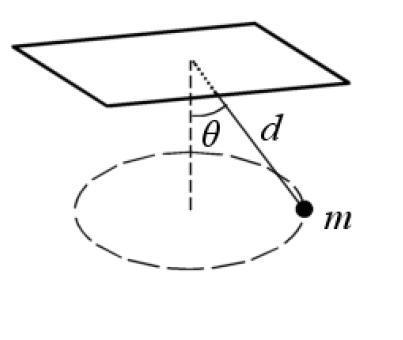

Consider a conical pendulum that consists of a bob
on one end of a string of negligible mass with the other end of the
string attached to a point on the ceiling, as shown. Given the proper
push, this pendulum can swing in a circle at a given angle, maintaining
the same distance from the ceiling throughout its swing. If the mass of
the bob is , the length of the string is d, and the angle at which it
swings is θ, what is the speed (v) of the mass as it swings? [Hint: Find
the vertical and inward radial components of the string’s tension.]
FR = (mv2)/r
For [tex]\Sigma[/tex]Fy I got FT = mg/cos θ
I said r = dsinθ
And for [tex]\Sigma[/tex]FR I got FTdsin2 θ = v2
Plug in mg/cos θ for FT and sqrt(gd tanθ sin θ)= v
Is that right?

I don't follow your equation for the radial forces. You have the Ft*sinθ component equaling the centripetal force, don't you? Surely there has to be an m in it. Why is the sin squared?
At the start I have
FTsin θ = mv2/r
Put in dsin θ for r and move to the other side
FTsin2 θ = mv2
Put in mg/cos θ from the y forces for FT
mgdsin2 θ/cos θ = mv2
The masses cancel and 1 of the sin2/cos becomes tangent
gd tan θ sin θ = v2
sqrt(gdtan θ sin θ) = v
Did I do something wrong? r is equal to dsin θ right?
:( from your image, I find that [tex]sin \Theta = \frac{d}{R}[/tex]
sin is opp/hyp right? r would be opp and d would be hyp. sin θ = r/d So dsin θ = r
No, your solution is perfectly fine. And yes, r = d sinθ. (In your first post you did leave off an m, as Delphi51 points out.)
