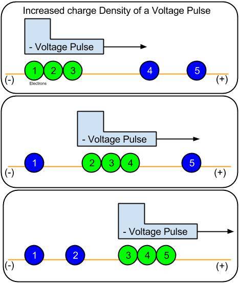

If I make a single, short (GHZ) negative voltage pulse propagate down a long, single wire which forms a closed circuit, will there be a corresponding negative charge density in the conductor (shown as bunched-up green electrons) which propagates with the pulse?
Three stacked panels titled Increased charge Density of a Voltage Pulse, showing a rightward-moving negative voltage pulse on a wire between (-) and (+) ends; green bunched electrons 2, 3, 4 travel with the pulse while blue electrons 1 and 5 stay outside it.
Thank you for the reply.
I was curious if the pulse would just propagate through the conductor like radio waves though space - without the need for or effect on electrons, but I just couldn't see there being this potential at some point in a conductor without an effect on the density of electrons in that region, however small that region or minuscule that density might be.
It's just a curiosity, but I didn't know!
