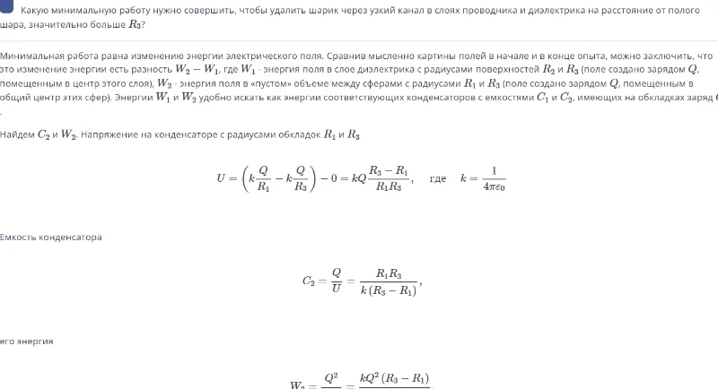

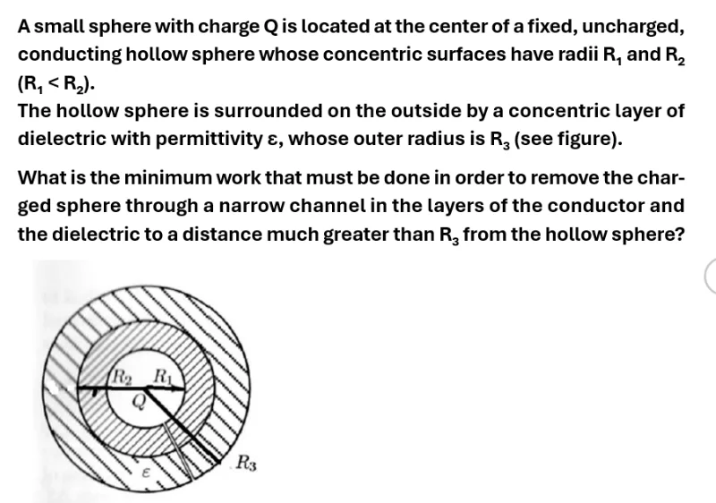

Can someone explain why is in this task used calculations in space R3-R1 and than in space R3-R1.
So i try to solving with conetion with electric-field energy. So i calculate electric field in region r<R1, and in region R3>r>R2 and r>R3 , with respect that E=0 at r>>R3. Inside layer of conducting sphere E=0.
On picture is part of solution and other is task.
Russian-language physics solution showing the task question and formulas: voltage U = kQ(R3 - R1)/(R1R3), capacitance C2 = R1R3/(k(R3 - R1)), and energy W2 = kQ^2(R3 - R1)/(2R1R3) given as Q^2/(2C2).
Problem text stating a small sphere with charge Q at the centre of an uncharged conducting hollow sphere with radii R1 and R2, surrounded by a dielectric layer of permittivity epsilon and outer radius R3, with a figure showing the nested spheres and asking for minimum work to remove the charge.
Please post a translation of the text in the (partial) solution.
