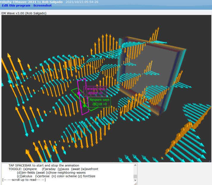

Here's a Glowscript version of my electromagnetic wave visualization.
https://www.glowscript.org/#/user/Rob_Salgado/folder/My_Programs/program/robphy-EMwave-2021
which is an update of my
ancient VPython versions
http://www.visualrelativity.com/vpython/EMWave-Maxwell_v277.py
http://www.visualrelativity.com/vpython/EMWave-030216.py
By showing what Ampere and Faraday do
[inspired by Chabay and Sherwood's phrasing as "curly" and anti-"curly" patterns from Electric and Magnetic Interactions ( 0471078476), the precursor to Matter and Interactions ( https://matterandinteractions.org/ ) ],
I am essentially using the same curl argument.
Use your mouse to move the loops.
Use right-click drag or similar to rotate the view.
Use the scroll-wheel or similar to zoom in and out.
My long-time dream has been to render this in terms of the electromagnetic tensor in spacetime,
or at least in terms of the Electric and Magnetic fields as animated spatial differential forms
[with respect to the 4-velocity of this lab frame].
