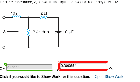

I'm going crazy. I've done this problem nearly 20 times and keep getting the same answer. I've read my textbook so many times too! What am I doing wrong?
Zcapacitor = 1/(jwC)
Zinductor = jwL
Zresistor = R
Z for the capacitor -j1.667*10^3
Z for the inductor is j0.6
Z1 contains the capacitor and resistor on the righthand side of the circuit
Z1 = 2 - j1.667*10^3
Calculate Z12 (Z1 in parallel with the 22 ohm resistor)
1/Z12 = 1/22 + (2+j1.667*10^3)/(2.78*10^6)
Z12 =21.99-j2.903*10^-1
Z123 = Z12 in series with the inductor = 21.99 - j0.2903 + j0.6 = 21.99 + j0.309
Don't forget to convert simple frequency f, which has units of Hz, to radial frequency ω, which has units of rad/sec.
Such a simple mistake on my part. Thanks.
