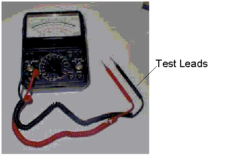

Have you ever seen a voltmeter in real life? It has two flexible wires (usually one is red and the other black) that end in rigid "test probes". The user touches the ends of the probes to the circuit at the points, between which, he wishes to determine the potential difference.
In your circuit the voltmeter leads are connected to points a and b, so it will measure the potential difference between points a and b.

Oh okay. And no, I am not too familiar with voltmeters.
So the voltmeter isn't really part of the circuit? The current first passes through r (50 Ohms) from the positive terminal of the battery and then splits at J. It meets back at the point right next to R3. It then passes through R3, past b, and goes back to the negative terminal of the battery.
The current that passes through b is 6 A and that current also passes through R3. So V = IR = 6*150 = 900 V.
