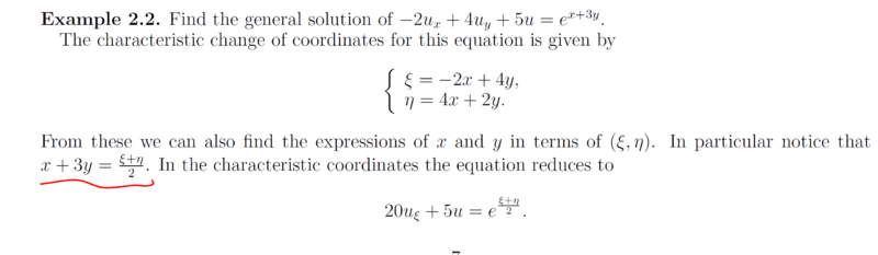

see attached.
My interest is on the highlighted part only...my understanding is that one should use simultaneous equation... unless there is another way hence my post query.
In my working i have;
##y=\dfrac{2ξ+η}{10}## and ##x=\dfrac{2η-ξ}{10}## giving us;
##x+3y=\dfrac{2η-ξ+6ξ+3η}{10}=\dfrac{5ξ+5η}{10}=\dfrac{ξ+η}{2}## cheers guys.
Why do you always have to question things like this? You have two equations for ## \xi## and ## \eta ## in ## x ## and ## y ## and you want to find two equations for ## x ## and ## y ## in ## \xi## and ## \eta ##: this is simultaneous equations by definition. You should do more thinking for yourself and not constantly seek assurance, this is not the way to develop confident problem solving skills.

I don't think this approach is the best approach to applying the method of characteristics.
Firstly I don't think it extends to non-constant coefficients, and secondly it leads to more complicated airthmetic in finding the integrating factor and solving the transformed PDE than does the approach of setting [tex] x_\xi = -2,\qquad y_\xi = 4[/tex] and then choosing [itex]x_\eta[/itex] and [itex]y_\eta[/itex] such that [itex]\eta[/itex] does not appear expressly in the transformed equation, leading to [tex] u_{\xi} + 5u = e^{10\xi + (x_\eta + 3y_\eta)\eta} = e^{10\xi}.[/tex] This approach also works for non-constant coefficient problems.

Thanks @pasmith ...i prefer the integrating factor method shown in the text for the time being... i need to try and study the approach that you are suggesting.
