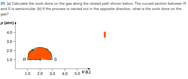

For part(a) of this problem,
The solution is, a. 160 J
In part (a), are they referring to the simi-circular path from R to S instead of the path from R back to R? I though the closed path would be the path from R to R, or the path from S to S, where both give W = 0 since ##W = P(V_f - V_i) = P(V_i - V_i) = 0##

They are referring to the complete cycle. For example, start at R and go to S along the semicircle and then return to R along the straight section.
The formula ##W = P(V_f - V_i)## gives the work done by the gas if the pressure is constant from ##i## to ##f##. For the semicircular part, note that ##P## is not constant.

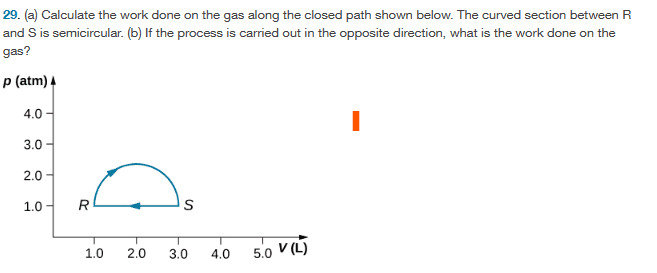

How can they talk about the curved path from R to S being a semi-circle? If you change the units of either P or V, the shape will change. It doesn't even look like a semicircle in the units shown in the figure. At the very least, they should call it half an ellipse.

From @Callumnc1's other posts, it appears to be a non-calculus course, so one has to be able to calculate areas without integration :frown:

The area of an ellipse is ##\pi ab## where a is the semi-major axis and b is the semi-minor axis.

If you look at the drawing, it certainly does not look like a circle because clearly the diameter is 2 units (L) long but the top of the arc is farther than 1 unit (atm) from the diameter. It seems to me that we should go along with the assertion that it is a semicircle instead of trying to read the value of the semi-minor axis from the drawing. The quoted answer is matches to 2 sig figs the semicircle assumption.
It seems to me that the person who drew the graph (as well as the final editor) should be fired. This is nuts.

Also to make sure I am actually finding the correct area, we are meant to be finding the area in orange correct?
This is because I know from the integral definition of work that the work done by the gas from S to R ##W_{SR}## will be negative since it compresses so displacement of container is in opposite direction to force pushing due to gas pressure. However, I don't think there is anyway we know just by considering the area under the curve from the diagram that the work from S to R is negative. I think we just have to look at the integral definition of work.
Before I knew that the work done by gas was path dependent, I thought that we could just find the work by considering the endpoints on the PV diagram so I wrongly thought that ##W_{RR} = 0## since it has a finial volume is equal to the initial volume.

To do the problem "their way" requires us to find the area from the PV graph. The area of the unit semicircle according to their description will be pi/2 and the unit of area is L-Atm. Thus the semicircular path work is $$W= \frac {\pi} 2 lAtm(101.325\frac J {lAtm})$$

##W=\frac{\pi (101325\times 1.5)(0.001)}{2}=239##

It is interesting to see the approaches to this problem by different people. @Chestermiller approach is to ignore the statement of the problem that asserts that the arc is a semi-circle and consider it half an ellipse. The shape could be declared an ellipse because the major axis is 2 units long while the semi-minor axis appears to be longer than one unit long.
However, if one measures the ratio of the horizontal axis to the height (I did with a plastic ruler against my computer screen), it is (to within experimental error) 2:1. So what does one believe? The tick marks or the statement of the problem and the proportions of the shape itself? I give the edge to the latter because it shows the intentions of the problem's author.
We have a semicircle of horizontal radius ##R_h= 1~\text{L}## and vertical radius ##R_v= 1~\text{atm}##. The area of this is the work $$W=\frac{1}{2}\pi R_h~R_v=\frac{1}{2}\pi~(1)\times(1) \text{(L}\cdot\text{atm)}. $$In MKS units and with the atmospheric pressure rounded off to 2 significant figures, $$1~\text{(L}\cdot\text{atm)}=(10^{-3}\text{m} ^{3}\cdot 10^5~\text{Pa}^3)=100~\text{J}.$$To 2 significant figures, which is the accuracy of the tick marks, ##W =100 \frac{\pi}{2}~\text{J}=160~\text{J}##. This answer matches the given answer.
It is clear to me that the author intended this solution. It is also clear to me that the author should have been more careful with the tick mark positioning to avoid the kind of confusion that has justifiably ensued.

Strangely enough you can actually also get the correct answer from ##W = \frac{1}{2}\pi(1 \times 10^{-3} m^3)(101325 Pa) = 160##. It really interesting how we don't get the correct answer if we do ##W = \frac{1}{2}\pi(1 \times 10^{-3} m^3)^2## or ##W = \frac{1}{2}\pi(101325 Pa)^2## from ##W = \frac{\pi}{2}r^2##, when according to the question statement (ignoring the diagram) ##r = 101325~Pa = 1 \times 10^{-3} m^3##
Maybe something to do with units?

Never mind it is because if we convert the units beforehand then it is no longer a simi-circle (imagine a graph of Pressure (Pa) vs volume (m^3) for the values, which means that we have to use the ellipse formula. Is this please correct @kuruman?
