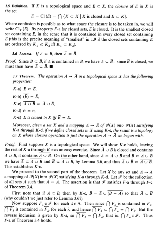

I need help in order to understand Willard Theorem 3.7 concerning topological closure ...
I am reading Stephen Willard: General Topology ... ... and am currently reading Chapter 2: Topological Spaces and am currently focused on Section 1: Fundamental Concepts ... ...
I need help in order to fully understand an aspect of the proof of Theorem 3.7 ... ..Theorem 3.7 and its proof read as follows:

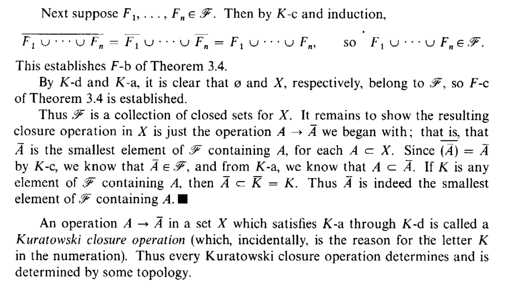

In the above proof by Willard we read the following:
" ... ... First note that if ##A \subset B##, then by K-c, ##\overline{B} = \overline{A} \cup \overline{ (B -A) }## so that ##\overline{A} \subset \overline{B}## ... ... "Can someone please demonstrate, formally and rigorously, how ##\overline{B} = \overline{A} \cup \overline{ (B -A) }## implies that ##\overline{A} \subset \overline{B}## ...
Help will be much appreciated ...
Peter

Hi. Something went wrong with wrong with the formatting. I think it follows from ##X\subseteq X\cup Y## for sets ##X,Y##.
(I deleted previous post, but it was correct).
I am probably being pedantic ... but it might be more accurate to say that ...
##\overline{B} = \overline{A} \cup \overline{ (B -A) }## implies that ##\overline{A} \subset \overline{B}## ... ... is true because ...
... for sets ##X, Y## and ##Z## we have that ...
##X = Y \cup Z \Longrightarrow Y \subset X##... ...
Peter
I would just write it like this:
##\overline{A}\subseteq \overline{A} \cup \overline{B - A} = \overline{B}##
