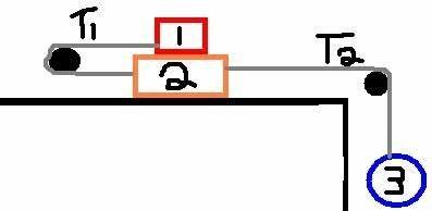

Coefficient of kinetic friction between the two blocks
1 reply · 8K views · last reply
Squeezebox
57
The coefficient of kinetic friction between the two blocks is 0.30. The surface of the table and pulleys are frictionless.
m1=2 kg
m2=3 kg
m3=10 kg
[tex]\Sigma[/tex]F=ma
T2-m3g=m3a
T1-T2=m2a
friction-T1=m1a
T2=m3g+m3a
T1=friction-m1a
friction-m1a-m3g-m3a=m2a
(friction-m3g)/(m1+m2+m3)=a
a=-6.15m/s2
The answer in my book say it is -5.7m/s2, though.
m1=2 kg
m2=3 kg
m3=10 kg
T2=m3g-m3a
T1=m1a+m1gμ
T2=T1+m1gμ+m2a
a=(m3g-m1gμ-m1gμ)/(m1+m2+m3)=5.7552
