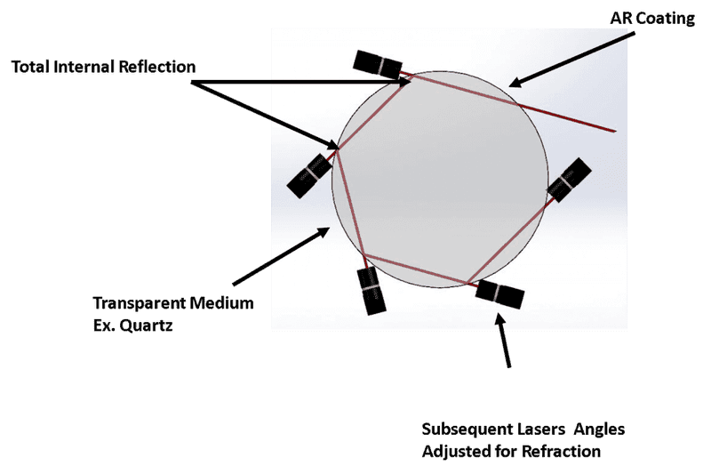

It looks like I am little late to this thread. I believe there may be an easier way to combine laser beams of any wavelength to make a more powerful laser. Here are couple of concepts of adding subsequent lasers at a point of total internal reflection and axially align multiple laser beams.
Example 1: Wave Guide Approach
Example 2: Virtuous Circle Approach
The closer to the edge of the denser than air transparent medium the more sides and the more lasers can be added. Now I have some concern that a cylindrical shape on the reflection point may upset the laser; so we can use multi-sided optic to be safe.Example 3: Hex My Ex Approach (Any uniform multi-sided shape will do)
I have a few more approaches that I came up with based on a different concept, but results are the same. As you may surmise in these basic examples you can daisy chain these elements together and make a very powerful laser or create a loop to cycle the light to make laser pump to make up for the inefficiencies. The number of lasers that can be added is limited to first laser not adding any additional photons to the output and that will be dependent on the precision of the system.
