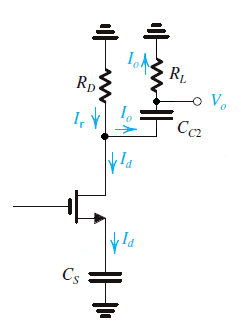

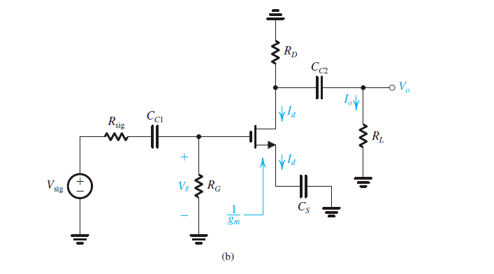

Here's the amplifier in question:

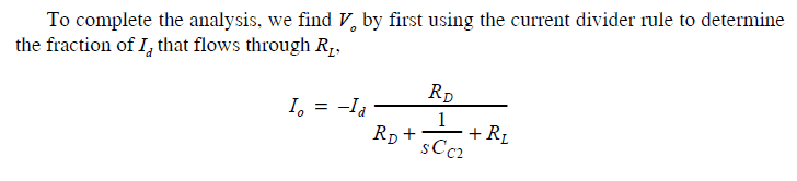

I'm not understanding this part:
Why is Cs not included in the current divider ?
To my understanding of current divider, It = Id+Io, where It is the current flowing through Rd
So, Io = It*(1/Cs)/(1/Cc2)+RL
But Cs is in series with Id current. Please explain to me how Cs affects Io.
Yes, it's correct. I must have gotten confused somewhere but it's fine now
