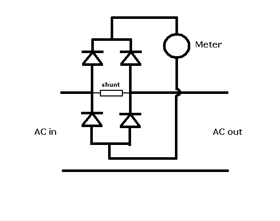

If the two signals are at some unknown phase to each other, you would have to rectify the signals and measure the currents as DC and then compare them.
Rectifying them would involve something like this for each signal:
Comparing them would depend on whether the signals had a common return wire or returns that could be joined together. If there was no common return, you could just have two meters and compare them visually, I guess.

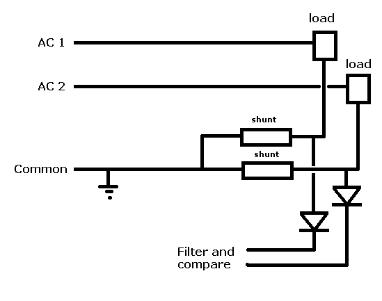

If they did have a common return, you could use something like this:
The voltage across the two shunts is rectified and filtered and compared.
Because there is a common ground, these DC voltages could be compared in a microprocessor so that allowances for small variations could be made.
