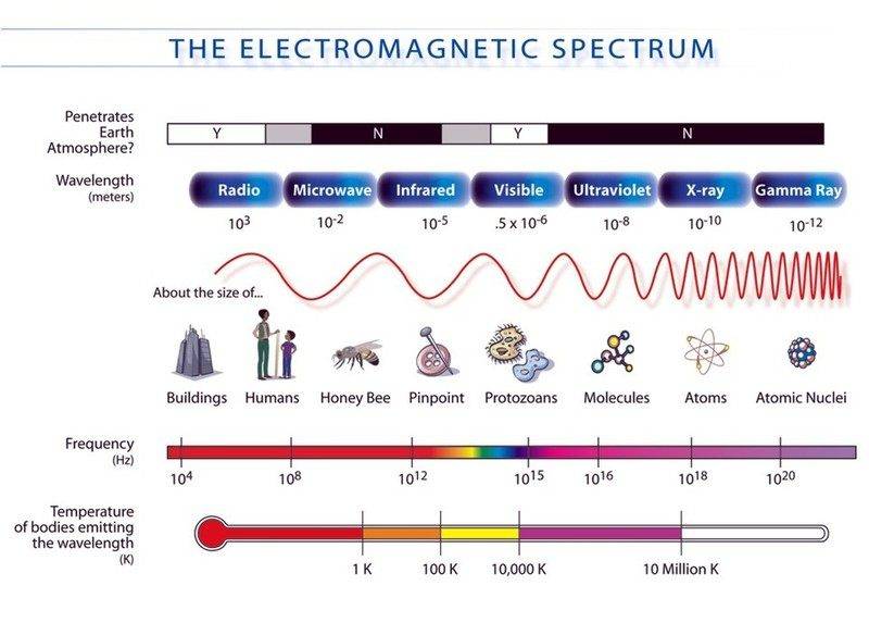

Radio waves, microwaves, infrared, visible light, ultraviolet, x-rays, gamma rays, cosmic rays. They are all describable in terms of photons of increasing frequency. (They are also describable as electromagnetic waves of decreasing wavelength.)
Whether or not we study them as part of one group and whether or not we generate them or detect them with the same instruments, they are indeed all the same thing.
Radio waves, microwaves, infrared, visible, ultraviolet, x-rays, gamma rays.
