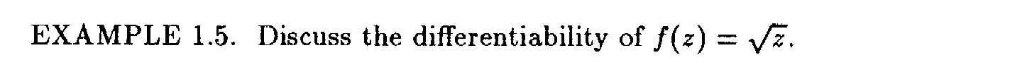

I have yet another question regarding Example 1.5, Section 1.2, Chapter III ...
Example 1.5, Section 1.2, Chapter III, reads as follows:

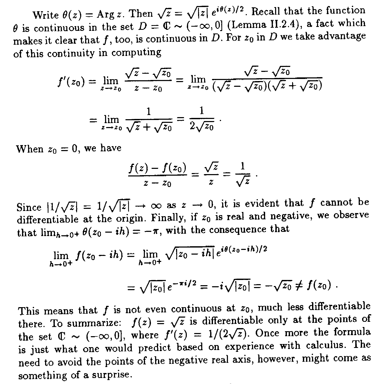

About half way through the above example from Palka we read the following:
" ... ... Since $$\mid 1/ \sqrt{z} \mid \ = 1/ \sqrt{ \mid z \mid } \to \infty$$ as $$z \to 0$$ ... ... "
Can someone please explain exactly how/why $$ \ \mid 1/ \sqrt{z} \mid \ = 1/ \sqrt{ \mid z \mid }$$ ... Help will be appreciated ...

The equation \mid 1/ \sqrt{z} \mid = 1/ \sqrt{ \mid z \mid } follows from the fact that absolute values of complex numbers and their reciprocals are equal. That is, for any complex number z, we have \mid z \mid = \mid 1/z \mid. Therefore, we can write\mid 1/ \sqrt{z} \mid = \mid \frac{1}{\sqrt{z}} \mid = \mid \frac{1}{\sqrt{\mid z \mid}} \mid = \frac{1}{\sqrt{\mid z \mid}}
