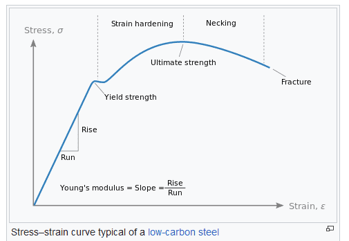

Do all of aluminum bars (or load cells) made from the same type of aluminum (i.e high purity aluminum or different types of aluminum alloys) share the same exact compressive strength or are there variations in compressive strength even among the same type of aluminum like high purity aluminum or same type of aluminum alloy?
What would cause the differences? Are you asking about small variations in the stress-strain curve due to small imperfections or slight differences in the alloying process?
https://en.wikipedia.org/wiki/Stress–strain_curve
There will be experimental variability. If you look at the standards, there are generally ranges for various parameters. Some standards are performance standards. Some are compositional standards. Some are processing standards. So the variability can vary by standard.
For example, two bars or load cells are made from the same aluminum alloy but maybe one of them is not as dense as the other thus not as strong in compressive strength due to some imperfections.
