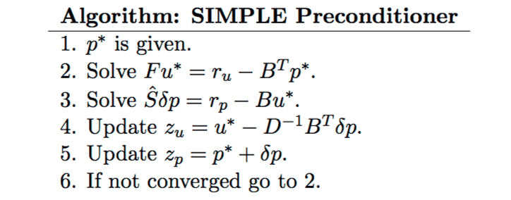

Let me simplify my question a little bit : let's say that I have INCOMPRESSIBLE VISCOUS fluid and my reynolds number is LOW which means NO turbulence exists and NO time dependent situation takes places. I am aware that SIMPLE algorithm found by Patankar can be used and it has segregated iterative solution which includes linear matrix equations in a specific sequence. BUT due to viscous, in the source term of energy equation we have DISSIPATION term which is non-linear. Therefore my question is HOW DO WE USE SIMPLE algorithm for the equations/cases that have non linear source term like dissipation function? OR what should we do IN THAT SITUATION??
If you have the book of Patankar (numerical heat transfer and fluid flow), you can check the sections on source term linearization, which is already mentioned in the chapter that treats heat conduction. A (more) common approach nowadays is to solve it as an unsteady problem using a pseudo-timestepping method, usually together with a multigrid method. There is no accuracy in time, the timestepping is just used to converge quickly to the steady state solution using large timesteps.

@bigfooted thank you for your return. I would like to ask some questions again if you don't mind, initially I searched the book chung, anderson... I did my best but not get satisfied, so my questions are :
1) In SUPERSONIC COMPRESSIBLE VISCOUS LAMINAR FLOW what kind of ALGORITHMS/METHODS SHOULD BE EMPLOYED??
2) In SUPERSONIC COMPRESSIBLE VISCOUS TURBULENCE FLOW what kind of ALGORITHMS/METHODS SHOULD BE EMPLOYED??
3) I think we can not use SIMPLE LIKE algorithms for previous questions because SIMPLE like algorithms have fixed point iterations and should reach unique point and all iterations have linear matrix equations as shown in my picture/attachement. For instance if source term of equation 3 in picture had non linear known velocity (like u^4 or u^5), then even if we know velocity from equation 2 or have the linearised form of those known velocities( like in Patankar ) we would still have power of velocities (u^4 u^5) and we would not have unique solution since all equations are not in linear matrix form. And real solution of fluid flow can not have different 2 solution at same time . Am I right??
4) Also in post 2 Nfuller does not agree that density based solvers are used. HE suggest Beam Warming or MacCormack like schemes. What do you say about that?
  • Pseudocode titled "Algorithm: SIMPLE Preconditioner" listing six steps: p* is given; solve Fu* = r_u − B^T p*; solve Ŝδp = r_p − Bu*; update z_u = u* − D^{-1}B^T δp; update z_p = p* + δp; if not converged go to 2.

SIMPLE methods cannot be used for compressible flow applications because they are used as a closure for the pressure in the incompressible form of the Navier Stokes equations. The continuity equation is used in the SIMPLE method.
