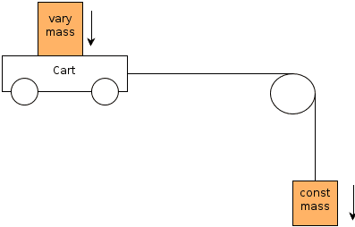

How do i compute theoretical acceleration and experimental acceleration?
Diagram of a cart on a horizontal track connected by a string over a pulley to a hanging block labelled const mass; the cart carries a block labelled vary mass, with downward arrows on both blocks.

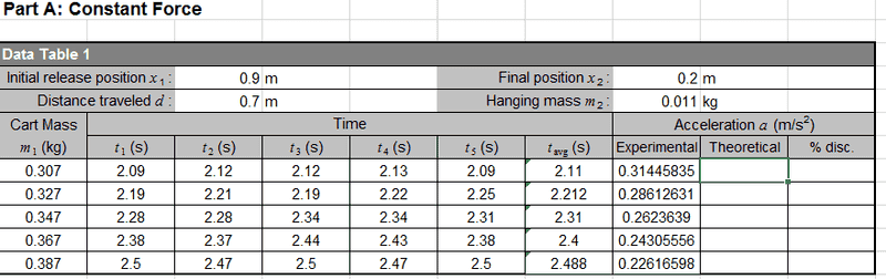

Data table titled Part A: Constant Force listing initial release position 0.9 m, distance traveled 0.7 m, final position 0.2 m, and hanging mass 0.011 kg, with cart masses, four timing trials, averages, and experimental acceleration values, theoretical and % disc. columns blank.
For the first sets of data, the experimental equation, i first averaged the timings.
Then i used:
s = ut + 0.5at^2, where u=0
0.7 = 0.5*a(2.11seconds)^2
a = 0.3144 m/s^2
but for theoretical acceleration, this is what i did.
m1 * g - T = m1 * a (eq 1)
T = m2 * a (eq 2)
Sub 2 into 1:
m1g - m2a = m1 * a
m1g = m1a + m2a
m1 g = a(m1+m2)
a = m1g/(m1+m2)
a = (0.307*9.81) / (0.307+0.011) = 9.47m/s
Where did i go wrong?
Which of the two masses 'feels' g ?
