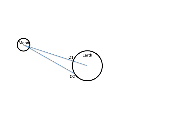

Well, not necessarily closer to the poles. It depends where the Moon is in its orbit and where you are on the surface of the Earth. Look at this sketch. Observer O1, on a line between the Earth's center and the Moon center, sees the moon in one location, relative to the fixed stars. Observer O2, at a different location, sees the Moon in a slightly different location, relative to the fixed stars. It's the angular distance between O2 and O1 that matters. O1 would be in a location where the moon is directly overhead, which obviously changes through the month and through the day.
