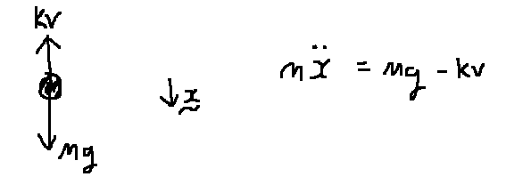

Here I have drawn for the following scenarios:
Linear Resistance FR = -k[itex]\vec{v}[/itex]
a)Free-fall starting from rest, downwards as positive.
Now it gets trickier...
b)Free-fall starting from rest, upwards as positive.
My reasoning is as such:
Since the resistive force always points opposite to the velocity vector, in this case the velocity is pointing downwards since the object is moving downwards:
v = -vi. Hence F = -bv = bv i
The force points upwards.

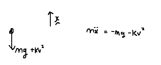

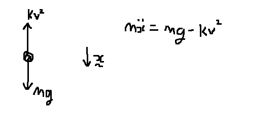

Quadratic Resistance
F = -bv2 i or bv2 i since it is v2 is not a vector...How do i determine its direction using vector methods?
a) Free-fall starting from rest, downwards as positive.
(Common sense) Opposes motion:
b) Free-fall starting from rest, upwards as positive.
The object is moving downwards, hence velocity is negative. To oppose velocity, resistive force points downwards.
However, I got all my directions wrong when taking the upward as positive! I don't know what is wrong with my reasoning!

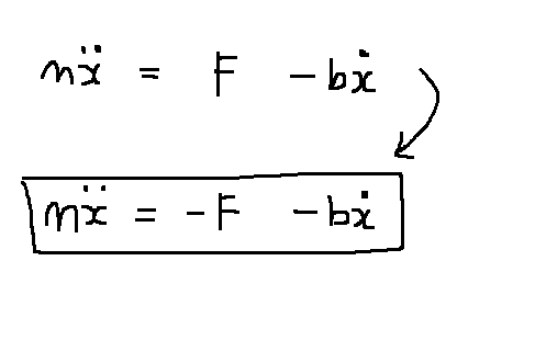

Ok reading my lecture notes again carefully I have come up with a new understanding:
The free-body diagram does not dictate the EOM, but rather the EOM leads to the free-body diagram:

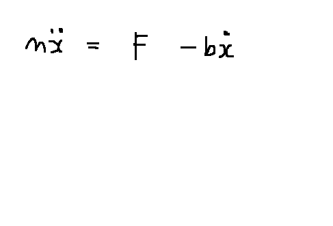

Linear Resistance
Suppose there is a force F (in this case, weight) that accelerates the object and a resistive force that is proportional to speed. If F is chosen to be in the positive direction (downwards), here is the equation of motion:
The resulting free-body diagram is as such:
b) Now, taking F in the negative direction (upwards as positive) , now F is negative. However, the resistive force will still be -bv [itex]\tilde{i}[/itex] as it always opposes motion; x regardless of the direction of x (upwards or downwards).

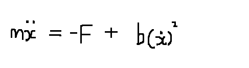

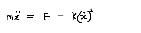

Now taking F in the positive direction, the EOM is given:
b)Now taking F in the negative direction, the EOM is given as this. But I have no idea why... I remember my prof mentioning something about it being independent of velocity or something...

Alright here's what's written in my notes:
"Although the linear case does not occur so often in reality, there are some slightly tricky issues to do with signs and directions. A typical equation of motion for this case is
ma = F - bv
where b is a constant. Remember that the choice of +ive direction for x determines the sign of F and other quantities. So if we choose F in the +ive x direction, F > 0 and vlimit = F/b.
If however we choose F in the -ive x direction then F < 0 but the resistive force will still be given by -bv (why?). The terminal velocity can then be written as vlimit = -|F|/b to emphasize the fact that the object is moving along the negative x-axis.
Consider now an object of mass m moving under constant gravity in the vertical plane subject to a linear resistance, initially at rest at height h. The coordinate y is taken positive upwards and the equation of motion is
ma = -mg -bv
[It is tempting here to write the RHS of the above as -mg + bv, but this is wrong since the resistive force is given by -av regardless of the choice of direction of coordinate axis.]
