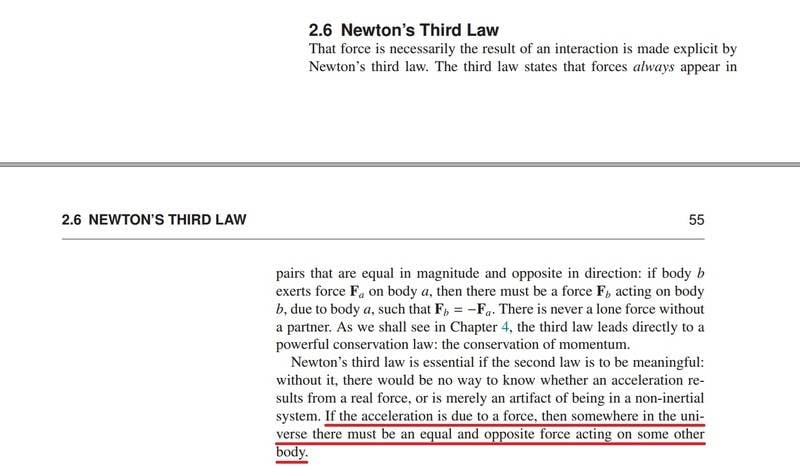

I have read section from "Kleppner and Kolenkow, An Introduction to Mechanics" about Newton's 3rd law of motion, What does red-lined sentence means ?
Why "somewhere in the universe ... on some other body" ?
Please explain.

The last paragraph basically says that the 3rd Law doesn't apply to inertial forces, only interaction forces between two bodies. But the key of the 3rd Law is the previous paragraph: conservation of momentum.

The whole concept of "inertial forces" is fraught with confusion. The terms thus named are not forces at all (that's why the third law does not apply to them), but rather some sort of mass x acceleration terms.
The part about "somewhere in the universe" simply means that we may not be readily able to locate the reaction force, but that it does in fact exist somewhere.

I think it is saying that if a force is causing an acceleration on a body then whatever originated the force is repelled by the same amount.

Just to follow on what Vanhees and A.T. have already said, Newton's Third Law does not apply to forces between bodies separated by large distances.
The third law applies to bodies that interact either through contact or forces over a negligible distance. (There is really no such thing as "contact" at the molecular level since all inter-molecular forces are electrical). In this respect the third law is not fundamental. Rather the conservation of momentum is the fundamental principle and the third law can be viewed as a consequence of that principle for bodies interacting by contact or over negligible distances.
The authors say that if a body experiences acceleration due to a force, another body in the universe will be experiencing an equal and opposite force. What is missing from this statement is the concept of time. A body that absorbs a continuous stream of photons from a distant source will accelerate. Those photons may have been traveling from the distant source for years. The body that emitted those photons would have experienced an equal and opposite "force" when it emitted the photons. So there can be a significant time difference between the equal and opposite "forces". However, photons carry momentum and at all times, momentum (of both bodies and the emitted photons) is conserved.
So rather than put it the way the authors of your text do, I would say: that if a body experiences a change in its motion, there is another body in the universe that experiences an equal and opposite change in motion such that the changes in momentum of the respective bodies (as measured in the same inertial reference frame) are equal in magnitude and opposite in direction.

In Relativity information cannot travel faster than c. Momentum is still conserved, when the fields are taken into account.

If we consider an object which emits a pulse of light towards another object at a significant distance (far enough that light-travel-time is appreciable) then we can say that the first object feels a force from the EM field which accelerates it in the opposite direction as the beam of light. Some time later, the 2nd object feels a force from the EM field which accelerates it in the same direction as the light, or away from the first object.
The problem here is that the 3rd law doesn't appear to allow for a time delay between the forces acting on one body and the forces acting on the other body. They are assumed to happen at the same time. We could try to say that the objects exert a force on the EM field, but that's very problematic. However, if we don't consider the 3rd law as fundamental, but instead consider conservation of momentum as more fundamental, then, as Andrew Mason said, everything works out just fine. The 3rd law can then be seen as arising from more fundamental conservation laws when the distance between objects is small enough.
