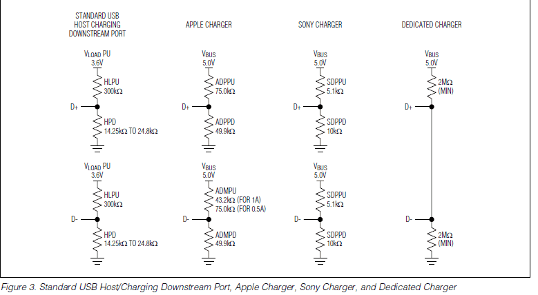

There seems to be a forum wide misunderstanding of how mobile device wallwarts and internal chargers work together. I've posted this stuff a million times. I need to make a FAQ.
This explanation has nothing to do with how to correctly charge a battery.
1. A mobile device wallwart (I am going to call it that to differentiate between it and the circuits in the device itself) is simply a power supply that powers the charger in the phone. The wallwart is TOTALLY isolated from anything to do with the batteries and how they are charged (other than the power demand from the device). Let's assume we are talking wallwarts with a USB like connector (+5, GND, DP, DN)
2. Mobile device charger circuits (in the device) have many modes and controls that may be affected by what wallwart is connected to them. They may decide to draw 2A from a wallwart that signals it can supply 2A. And only 100ma from a USB port that won't give it 500ma. Or anything in between.
A classic example is the ipad charger. You can't plug an ipad into just any old USB compatible charger and expect it to charge. The ipad looks for specific voltages on the DP and DN pins that signal the capacity of the charger. Other phones have their own proprietary protocols, and the USB specification has its own protocol (based on subthreshold signalling on DP and DN.
Many phones will charge at whatever they like if they see DP and DN are shorted. This can cause low capacity wallwarts to burnout when connected to high demand devices.
Here is an old example of what the wallwarts present to the mobile device
http://datasheets.maximintegrated.com/en/ds/MAX14578AE-MAX14578E.pdf (this is an IC inside the mobile device that looks at charger signals and tell the device cpu what it sees so it can configure the charger properly)
Here is a table of some of the "protocols" (I'm using the word protocol pretty loosely, but in some cases there actually is a pretty complex protocol)
Notice that the APPLE CHARGER has different resistor values to indicate 1A and 0.5A. Notice the DEDICATED CHARGER has pins DP and DN shorted.
If you really want your head to spin, read the USB specification for battery powered devices.
https://en.wikipedia.org/wiki/USB#Charging_ports summarizes it nicely.
SO, in summary, wallwarts "communicate" with the mobile device (in a sometimes very rudimentary way) to indicate their capability and the device adjusts accordingly. But, there is no real standard and it is possible a device might try to draw more than a wallwart can handle, possibly damaging the wallwart and/or the device. That's why I ALWAYS try to use OEM chargers. Especially on larger devices.
