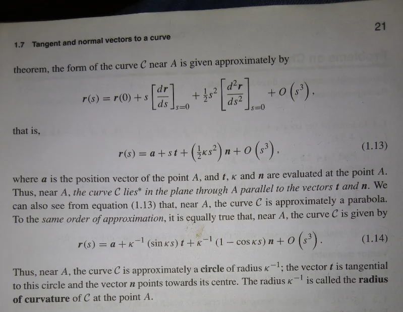

Can anyone tell me how Gregory gets equation 1.14 from equation 1.13?
Can you upload a pic of that page? Use the "Attach files" link below the Edit window. Thanks.
Sure...
Looks like Taylor expansions for ##\cos## and ##\sin##
terahertz said:
TL;DR: Classical Mechanics, Douglas Gregory
The way I would look at it, he actually gets equation 1.13 from 1.14 (using Taylor expansions). I.e.:
$$\kappa^{-1} \sin(\kappa s) = \kappa^{-1}(\kappa s - \frac{\kappa^3 s^3}{3!} + \dots) = s - \frac{\kappa^2}{3!}s^3 + \dots$$And:
$$\kappa^{-1}(1 - \cos(\kappa s)) = \kappa^{-1}(\frac{\kappa^2 s^2}{2!} - \frac{\kappa^4 s^4}{4!} \dots) = \frac 1 2 \kappa s^2 - \frac{\kappa^3 s^4}{4!} + \dots$$In my experience, physicists have this somewhat curious tendency to work backwards without saying so. For me, personally, it seems odd. But, you have to get used to it.
