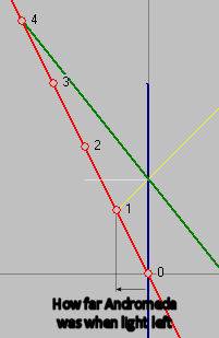

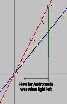

To illustrate, here are the space-time diagrams for our approaching and receding observers.
Approaching:
Red line is Andromeda, Green is approaching observer, Yellow line is the light traveling from Andromeda and reaching observer when he passes receding observer (blue line). The black arrow is the distance between observer and Andromeda when the light left. The white line marks off what time it is "now" at Andromeda according to our observer when he sees the light.
Receding:
Same meaning for the Lines. We see that Andromeda was closer to our Observer when the light left, and thus took less time to reach the observer. Thus the "Now" line for the observer crosses Andromeda's line at a different point then it did for the approaching observer ( between ticks 1 and 2 instead of between ticks 2 and 3.)
Approaching:
Receding:
Same meaning for the Lines. We see that Andromeda was closer to our Observer when the light left, and thus took less time to reach the observer. Thus the "Now" line for the observer crosses Andromeda's line at a different point then it did for the approaching observer ( between ticks 1 and two instead of between ticks 2 and 3.)
Thanks a lot.
I will to work whit these diagrams for understand what they mean.
