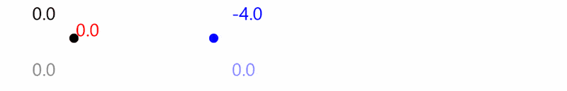

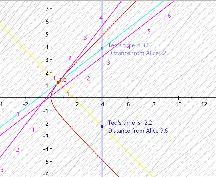

I've been working on a Minkowsky spacetime diagram generator. The software is probably way overkill, but I'm retired and it keeps my brain active. I am no physicist, but I am a pretty good programmer.
Side note: if you have any interesting things to diagram on a 2D Minkowsky spacetime diagram, let me know. I need good test cases.
The software is complete enough that I can draw diagrams, but I'm still hunting for bugs. The software has the ability to define a problem with respect to one inertial frame and draw it with respect to another. It also allows for animations, and I can set up animations where every frame is drawn relative to a different inertial frame. This makes it possible to view things from the point of view of an accelerated observer in a variety of ways.
Here is a simple setup I tried. An observer accelerating at 1g travels 4 light years. At (0,0), the accelerating observer's velocity is 0. We'll call her Alice. There are two other observers, one at (0,0) (Bob)and one at (4,0) (Ted), both at rest with respect to each other and to Alice (at time 0). Here is a diagram that includes just Alice's worldline.
The solid colors represent where Alice sees Bob (black) and Ted (blue). The solid numbers represent the times she would see if Bob and Ted displayed huge clocks and Alice had a powerful telescope. The faded colors represent the calculated position (per Alice) of Bob and Ted, and the faded numbers are their calculated clock times. For example, Alice starts out seeing Ted 4 light years away and displaying a clock time of -4.
Here is an animation of the scenario, from Alice's point of view, from time 0 until she reaches Ted.
Since we are viewing this from Alice's point of view, her position doesn't change. I believe this animation is correct, but it surprised me. As Alice accelerates toward Ted, Alice sees Ted receding into the distance—at least, until his clock reaches 0.
Let me know if this animation looks wrong and in what way.

I'm a bit confused about what's what. The Minkowski diagram looks fine, but I'm not sure what the gif is supposed to be showing me. Are you trying to represent what Alice actually sees? If so I'm not sure it's right for the eternally accelerating observer in your Minkowski diagram since she shouldn't see the blue guy at 4ly. Or are you trying to depict the distance to the blue guy in Alice's momentarily co-moving inertial frame? That looks more plausible, although I haven't checked the maths. What are the fainter dots in the animation?
I don't understand your question, the part about seeing "the blue guy at 4ly." The blue guy is Ted and he is always visible to Alice. At time 0, she sees Ted as 4 LY away and with a clock reading of -4 years. At Alice's time 2.2 years, she reaches Ted, who now displays a clock time of 4.9 years.
Exactly. Every instant in the animation is from Alice's view.
The fainter dots represent where Alice calculates the positions of Bob and Ted. The fainter text represents the clock times she calculates fro them.
For example, at time 0, Alice sees Ted's clock reading -4 years, but calculates his clock (along her current line of simultaneity) to read 0. At that instant, of course, her inertial frame matches Bob's and Ted's.

...then I am confused again. Can you sketch on the Minkowski diagram or state mathematically what calculations you are doing at some arbitrary time after t=0?
PeterDonis said:
How are you calculating "Alice's point of view". You can't just be reading it off a Minkowski diagram, because Alice is not an inertial observer, so any coordinate chart in which Alice is at rest cannot be a Minkowski coordinate chart. What chart are you using?

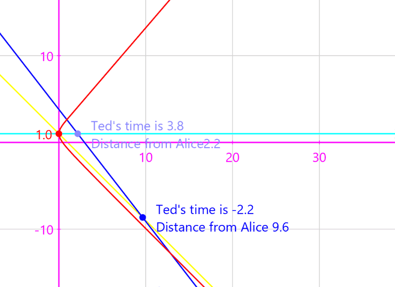

Yes, I am using Minkowsky spacetime diagrams. Any single frame of the animation is a Minkwosky spacetime diagram using Alice's instantaneous moving frame (IMF). The IMF changes for each frame.
Unfortunately, some of the animated diagrams that make it clearer are too big to post here. I may try to post a few stills when I get a chance.
But how I do it seems irrelevant. If you were Alice, would you see Ted recede as you accelerated towards him?
So how are you calculating where Bob and Ted are if you're changing frames all the time?

Since I am viewing things from Alice's viewpoint. their worldlines remain lines, but they don't remain vertical.
Your version of "Alice's viewpoint" is not a single frame but a mishmash of frames changing at every instant, so it is meaningless to talk about the shape of any worldline in your version of "Alice's viewpoint", since there aren't even any worldlines in it, only a series of snapshots, each of a different frame at a different instant.
If you think I am implying that your version of "Alice's viewpoint" is not a good way to analyze Alice's viewpoint, you are correct.

OK, so I think I understand what you are doing now, @Freixas. Ted emits a pulse of light which arrives at Alice at some time when she has velocity ##v## in the frame shown in the Minkowski diagram in your OP. You transform to the inertial frame with velocity ##v## (so Alice is instantaneously at rest) and calculate the distance in this frame between Alice and Ted at the times in this frame of the emission event (dark blue dot) and reception event (pale blue dot). Right?
The problem is that using an instantaneously co-moving inertial frame like that gives you inconsistent results, essentially because Alice is rewriting her history: she is always stationary now and moving in the past, and what she said a moment ago about being stationary is forgotten. We have always been stationary with respect to Eastasia, you might say. So, for example, using your method the "distance now" when Ted's clock reads zero is 4ly, but the "distance when she sees his clock reads zero" is not 4ly - it's about as far to the right as you can go in your gif. So you don't have a consistent measurement of distance because of this rewriting of history.
What you need to do is have a consistent coordinate system - Rindler coordinates work for this case, or more generally radar coordinates (https://www.mrao.cam.ac.uk/~clifford/publications/abstracts/ced_twins.html) are very useful.

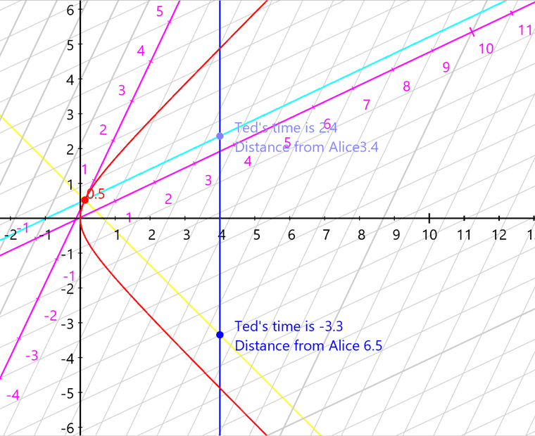

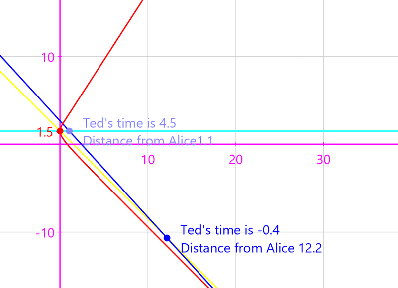

I said I'd post some other diagrams. It's pretty easy with my tool to switch the viewpoints and change various parameters.
