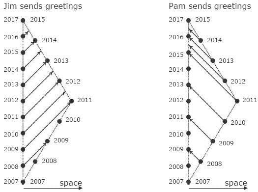

How about this diagram? Jim is stationary on the Earth and Pam is in the drivers seat of the spaceship.
Hmm, how will this "Jim sends greetings"-diagram add up with the diagram drawn in the youtube video.
In the youtube video Pams notion of what is simultanous on Earth (after she has accelerated) will be ahead of her own time.

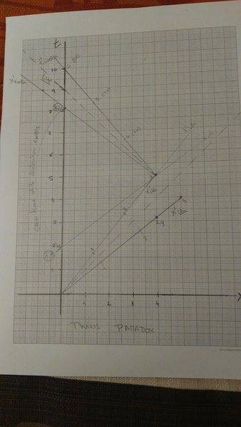

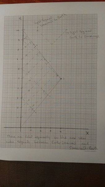

I was very happy, when i have made this work. I always love relativity and now y can learn about that:smile::smile:. Work is in the images.

I submit you the statement of the problem, traslation is from spanish. The numbers in the problem are well selected for easy calculus.
PROBLEM
In New Year day of 2050, Danae go out from the Earth to alpla-Centaurus, 4 light-years away from the Earth, Danae travel with an speed of 0.8c. Just Danae make your goal, she cames back to the Earth at the same velocity, and landing in the same point the New Year of 2060.
Danae has a twin, Apolo, that stand at rest in the Earth. They agreed to communicate by radio signals every day of the new year, until Danae cames back.
You must construct the space-time diagram for the voyage and the radio signals. Also you can use the lorentz contraction or dilation of time for calculations.

C) Space-time diagrams may be of some help - posters have already drawn some for you, but you may not understand them unless you draw some yourself. They don't have to be pretty. Compare what you draw to what other posters have drawn.
In part two of your post, you talk about "the light from Alice that Bob recieves". In part one of your post, you are talking about somethign else, "what Bob experiences". This is apparently a different notion form what you talk about in part 2, the signals that Bob recieves. As you point out, there is nothing ultra-rapid going on in part 2, but there is something ultra-rapid going on in part 1.
What you need to think about is what you mean by the notion you write about in part 1, which is different from the notion in part 2. How is it different?
Hint. The notion that you use in part 1 most likely involves the concept of simultaneity. Can you phrase your question in part 1 in terms that involve the word "simultaneous"?
Kontilera said:
I feel that I understand the twin paradox perfectly when looking at the signaling diagram and the plane-of-simultanity diagram separate. But I can't figure out how they can be compatible with each other.
Lets say Bob looks at Earth right before the acceleration.
He observes the 1984 Olympics 100 final start and that Earth is 10 light days away.
Using his formula:
(The time it is on earth) = (The time I observe on earth) + (The time it took the light to reach me)
He concludes that the 1984 Olympics 100 final start was exactly 10 days ago.
Now he makes his super fast, mind blowing, acceleration. Which in the Earth reference frame may have taken 1 microsecond and only moved him about some meters. (I don't won't do the calculations here cause you get the idea of what I´m getting at.)
After the acceleration he (according to the signaling diagram) will observe a moment that is slightly later that the start of the Olympics final. Maybe the difference is some microseconds..
He will again use his formula to calculate the correct time on earth.
The time he observes on Earth is only some microseconds later and the time it took light to reach him is the same (assuming that the acceleration is "symmetrically performed".)
Thus, I cannot grasp (within this perspective of the problem) how he can claim that the simultaneous events on Earth changed so much due to the acceleration..
