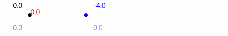

  • #61
Freixas said:
the same setup but from Alice's viewpoint:
Alice is not at rest in this diagram (her worldline is not a vertical line), so I don't see how this represents "Alice's viewpoint", for the reason I've already given: changing frames from event to event on Alice's worldline does not give "Alice's viewpoint", since it does not result in a single valid coordinate chart covering the region of spacetime of interest, in which Alice is at rest.

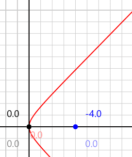

  • #62
Freixas said:
red is Alice's worldline.
Isn't Alice supposed to have been at rest, co-located with Bob, until she starts accelerating at time ##t = 0## in the "Bob's viewpoint" diagram?
If so, that diagram only shows her worldline correctly after ##t = 0##, not before it. Before it her worldline should be a vertical line co-located with Bob's.

I've been working on a Minkowsky spacetime diagram generator. The software is probably way overkill, but I'm retired and it keeps my brain active. I am no physicist, but I am a pretty good programmer.
Side note: if you have any interesting things to diagram on a 2D Minkowsky spacetime diagram, let me know. I need good test cases.
The software is complete enough that I can draw diagrams, but I'm still hunting for bugs. The software has the ability to define a problem with respect to one inertial frame and draw it with respect to another. It also allows for animations, and I can set up animations where every frame is drawn relative to a different inertial frame. This makes it possible to view things from the point of view of an accelerated observer in a variety of ways.
Here is a simple setup I tried. An observer accelerating at 1g travels 4 light years. At (0,0), the accelerating observer's velocity is 0. We'll call her Alice. There are two other observers, one at (0,0) (Bob)and one at (4,0) (Ted), both at rest with respect to each other and to Alice (at time 0). Here is a diagram that includes just Alice's worldline.
The solid colors represent where Alice sees Bob (black) and Ted (blue). The solid numbers represent the times she would see if Bob and Ted displayed huge clocks and Alice had a powerful telescope. The faded colors represent the calculated position (per Alice) of Bob and Ted, and the faded numbers are their calculated clock times. For example, Alice starts out seeing Ted 4 light years away and displaying a clock time of -4.
Here is an animation of the scenario, from Alice's point of view, from time 0 until she reaches Ted.
Since we are viewing this from Alice's point of view, her position doesn't change. I believe this animation is correct, but it surprised me. As Alice accelerates toward Ted, Alice sees Ted receding into the distance—at least, until his clock reaches 0.
Let me know if this animation looks wrong and in what way.
