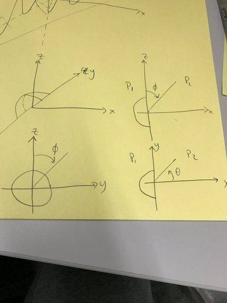

It doesn't make sense to me. As I said, ##\phi##, the longitudinal angle should integrate out because the flow is symmetric about the x axis. I think you are having trouble applying spherical coordinates. ##\theta ## should only run from zero to pi/2. ##\phi## should run from 0 to 2pi. Please draw a diagram showing your understanding of the angle ##\theta##. What do you get for the rate of x momentum entering if you use my relationship, and how does it compare with your result?
I drew it as best I could. I included pressure on each side so you have more reference.
  • Handwritten sketches of coordinate axes on yellow paper: a 3D set of x, y, z axes with angle labels, and three 2D planar diagrams showing z and x or y axes with labels P1, P2, phi and theta marked by arcs and a shaded half-disc.
Chestermiller said:
The x-compoent of fluid velocity is ##\frac{Q}{2\pi r^2}\cos{\theta}##.

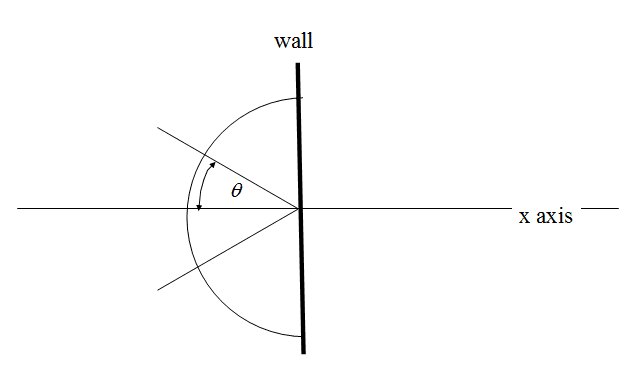

So this is what I don't understand. It seems to me the magnitude of velocity ##V = \frac{Q}{2\pi r^2} \implies \vec{V} = -\frac{Q}{2\pi r^2} \hat{r}## (since it enters radially, and ##\hat{r}## is an outward unit normal in the radial direction). Then the x-component is ##\vec{V} \cdot \hat{i}= -\frac{Q}{2\pi r^2} \hat{r} \cdot \hat{i} = -\frac{Q}{2\pi r^2} \cos \theta \sin \phi##.
Diagram of a vertical wall with a horizontal x axis through a point on it, showing a wedge of angle theta opened to the left of the wall, with a dashed arc marking the angle.
x component of velocity is ##\frac{Q}{2\pi r^2}\cos{\theta}##. This is because theta is the angle any spherical coordinate radial line (any line drawn from the origin) makes with the x-axis. The surfaces of constant ##\theta## are cones.
But the force balance is integrated over ##\rho \vec{V} (\vec{V} \cdot \hat{n})##. I am unable to reason through your approach using this technique. Do you have a vector expression for ##\vec{V}## in terms of cartesian unit vectors?
Hi Josh,
I see now what our difficulty on communicating on this problem is. You are interpreting the x-direction on the figure literally as the usual x Cartesian coordinate direction typically employed in relating spherical coordinates to Cartesian coordinates. I am viewing it conceptually as if the labels on the axes had been switched. Suppose we were to switch the axis labels such that the direction of the jet were taken as the z direction (rather than x), and we were trying to determine the force in this z direction. In this case, the wall in the figure would be the x-y plane (perpendicular to the z-axis). The fluid flow would then be axi-symmetric with respect to the z axis. If, as is usually done in spherical coordinates, the angle ##\theta## were measured relative to the positive z direction, then ##\theta## would run from ##\pi/2## to ##\pi## in the left-hand part of the figure. Does this make any sense to you now? Would you be able to more easily perform the momentum balance using this framework?
Chet
