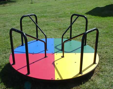

I have some problems understanding when a system is isolated or not. I know the definition:
An isolated system is a system which is free from the influence of a net external force which alters the momentum of the system.
Well, my confiusion is better shown by an example.
Consider an Merry-go-round (MGR):
A person runs towards the MGR while the MGR stand still. Call this situation 1). He the jumps on it. This obviously makes the MGR rotate. Call this situation 2). Define that for the spin, the center of rotation is in the middle of the MGR.
Im confused regarding what properties is conserved. Angular momentum, energy and (linear momentum). If you don't care about my ramblings, you can stop read now ;p
I would think that momentum (linear, p=mv) is not conserved. In 1) the person running makes the system have a p>0, but in 2) the system will only have angular momentum, i.e p=0. Is this correct?
I would say that energy is not conserved due to the fact that it is friction that makes the person stick to the MGR. But I am not sure about this. I can think of situations where one would not need friction to stick to the MGR, for example if one run into a wall placed on the MGR perpedicular to it. This makes me confused.
And then you have angular momentum (spin). The person has angular momentum around the axis of rotation just before he hits the MGR in 1). in 2) the MGR and person both have Angular momentum. I would say that the spin is conserved, because there is no external net torque acting on the person-MGR system. However, you have that friction again.. One can perhaps look at the friction as a torque.

Linear momentum of the system is not conserved. The MGR is fixed by its axis, which exerts an external force on it.
However the person 'sticks' to the MGR, the person essentially makes an inelastic collision with the MGR. Mechanical energy is not conserved. (The same would be true if the person just ran and jumped onto a wagon.)
There are no external torques acting on the system. (Presumably, the axle of the MGR is frictionless and exerts no torque.) Whatever forces the MGR and person exert on each other (whether friction or other), those forces produce no net torque on the system. Angular momentum is conserved.

And why can you neglect the force acting from the axis on the system in the angular momentum case, but not in the linear momentum case?
Do I got it right:
-Isolated system for angular momentum <=> no external net *torque* action on the system
-Isolated system for linear momentum <=> no external net *force* acting on the system
Why is the force from the axis considered external anyway? It is a part of the carousel, and thus a part of the system, and thus internal, not external.

Whenever things collide and stick together, mechanical energy is 'lost'. You can prove this for yourself by setting up a few simple examples of colliding objects and applying conservation of momentum to find the final speed after the collision.
The reason is just as you state next:
Do I got it right:
Right!
It's perfectly OK to consider the axle as part of the system if you like, but then realize that something must be exerting a force (an external force) to hold the axle in place.

Here you go:
m ≡ mass of person
p ≡ initial momentum of person
I ≡ rotational inertia of MGR
Assume that the person is moving tangentially to the MGR.
Conservation of angular momentum:
Rp = (I + mR2
Initial KE: ½p2/m
Final KE: ½(I + mR22 = ½R2p2/(I + mR2)
As long as I > 0, the Final KE will be less than the Initial KE.
