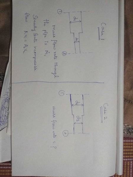

Can we apply continuity equation between the given two cases?
The only difference in the second case is that the pipe of diameter d2 is replaced by a pipe of diameter d3.
Will the mass flow rate be same for both the cases.
The mass flow rate will not necessarily be the same in both cases, but within each case, the mass flow rate through each of the two tubes will be the same. The latter is a consequence of the continuity (conservation of mass) equation.

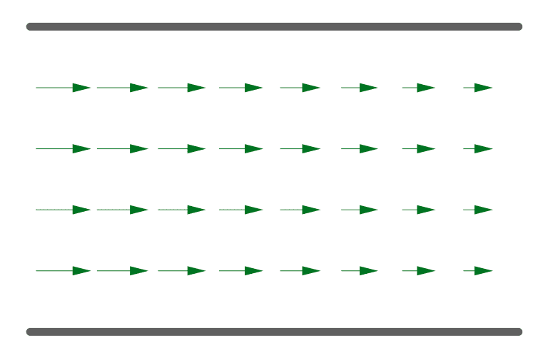

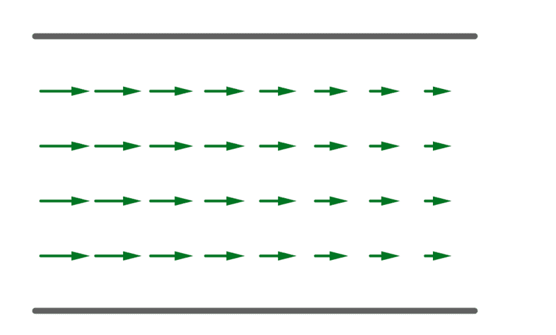

Of course... But I still can't wrap my head around the fact that, for this to happen, the flow must be non-stationary.
I'm trying to picture the situation in my head. The flow becomes slower as the fluid proceeds. As the velocity decreases (with distance) the density increases. Of course, if the decrease in velocity is proportional to the increase in density, the same mass of fluid goes through any section.
Is it possible for the density to increase faster than the velocity decrease? Like the fluid becomes very compressed?
Maybe I get it.
The book I have defines a stationary flow as a flow whose velocity field does not change in time. But maybe this is not enough, it is not just a matter of velocity. Should everything be time independent? Is this what you mean by steady state flow?
Thanks again

No. By steady state, what I mean is that, at a given location in the flow channel, the velocity and density don't change with time. However, they do change with spatial position within the flow channel.
Yes, I'm clear on that now.
So in a steady flow both the velocity and the density should be time-independent at a given point in space. I guess that this applies to all the properties of the fluid, including e.g. its pressure and temperature.
What I'm not clear about is whether a stationary velocity field is a sufficient condition for a steady state flow.
If the velocity only depends on the spatial position, but does not depend on time, can we conclude that all the properties of the flowing fluid (pressure, density...) are time independent?
If this is the case, is there a simple argument showing that?
Or in principle the velocity of a fluid can be time-independent while its density for instance changes in time?
I'm asking this because the book I have just says that "in a stationary flow velocity does not change with time" and seems to give mass flow conservation for granted, without (explicitly) assuming that the density should be time-independent too .
It seems to me that one of the two thing should be assumed. Either the density is also time-independent, and hence mass flow conservations seems a natural consequence, or mass flow conservation is assumed, and hence the time independence of the density is a natural consequence.
Am I making sense here?

Steady state is defined as a flow and heat transfer situation in which, at each position in space, nothing is changing with time. So, at any given position, velocity, temperature, density, pressure etc. are all constant. In most flow and heat transfer systems, all you need to do is have a constant inlet flow rate and then wait long enough for steady state to be achieved.
As far as stationary is concerned, even though I have had years and years of experience with fluid dynamics, I am not familiar with the use of that term. What does it mean to you?
