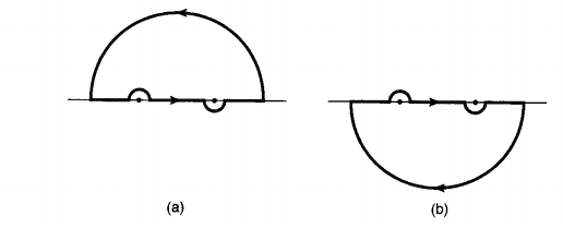

This is solution of Griffith problem 11.16
This is procedure to get a 1-D integral form of Schrödinger equation.
I don't understand why that contour integral include only one pole for each contour?
A pole contributes only if it is inside the closed contour. (I could be misunderstanding your question.)
